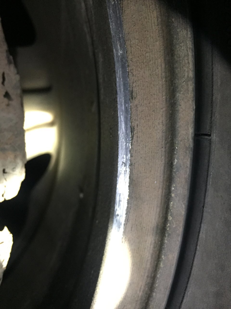

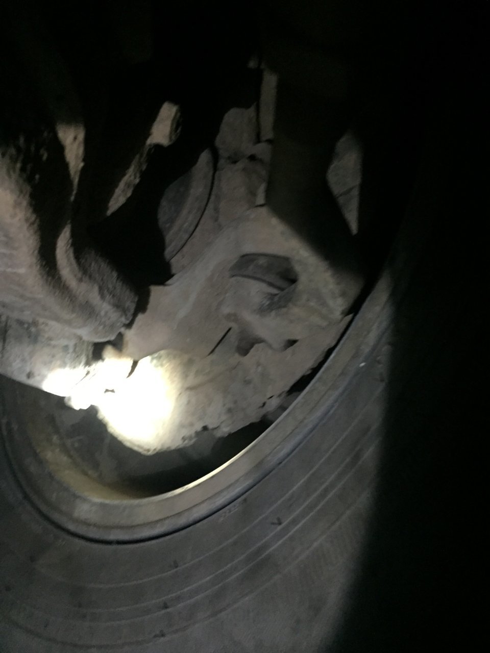

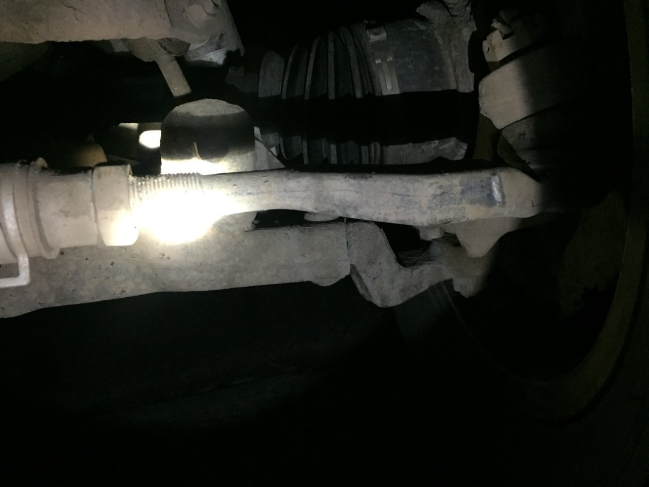

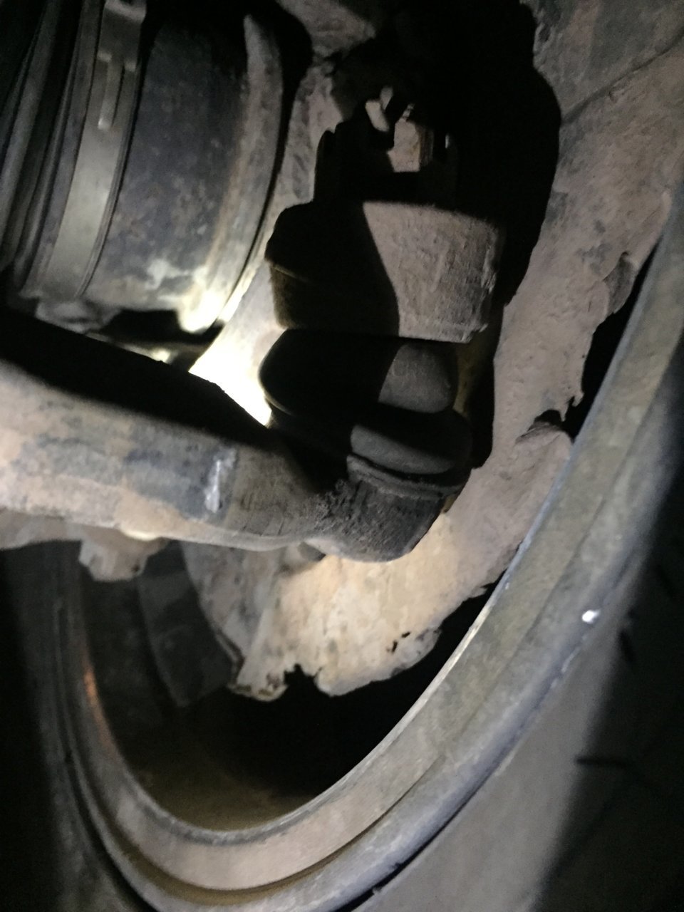

    UPDATE*thread revival
    It was the wheel grinding on front suspension.:mad: It appears that they reversed (flipped from correct side) the component that connects on the front right tire.(idk what called) it is stock wheel and stock tire size. All around the wheel on the inside I see it. There are lil metal flakes on the part and on the wheel. What should I expect when I take it back? Are they going to blow me off and say it wasn’t them? :bananadead:

  12. Nov 25, 2019 at 4:12 PM
    jbrandt
    jbrandt Made you look
    Feb 12, 2011
    #51038
    17,612
    Justin
    El Dorado, CA (NOT El Dorado Hills)
    '04 TRD Tacoma 4x4 DC
    Kings, J59's Total Chaos UCAs Custom skids Sticker mod
    Well, it sounds like it's been 2 months since you had the lift installed, I doubt they'll be willing to do much for you at this point.
    Can you take some pictures of your front suspension, a view kind of like this: and maybe one from the back so we can see where the steering connects to where the wheel is.

  17. Nov 25, 2019 at 4:44 PM
    #17
    jbrandt
    Feb 12, 2011
    #51038
    17,612
    Justin
    I think that looks like your dust shield on the front brakes that's rubbing the wheel. It's the thin piece of sheet metal that's right next to the brake rotor (but doesn't spin with the wheel.
  18. Nov 25, 2019 at 4:52 PM
    #18
    tacomainthesun
    tacomainthesun [OP] Well-Known Member
    Jul 11, 2018
    #258984
    743
    02(sold) 17 trd or
    Oh. I don’t like how it rubs on the other thing tho. I’m assuming I just need to have that piece flipped just like the drivers side to fix it
  19. Nov 25, 2019 at 4:55 PM
    #19
    jbrandt
    Feb 12, 2011
    #51038
    17,612
    Justin
    It looks like it has seen better days. It's obviously doing a lot of damage to your wheel. You can either replace it with a new one that's not all bent up, or just trim a little bit of it off so it doesn't rub anymore...
  20. Nov 25, 2019 at 4:55 PM
    #20
    tacomainthesun
    Jul 11, 2018
    #258984
    743
    02(sold) 17 trd or
    No it’s not it connects to steering idk what it called
