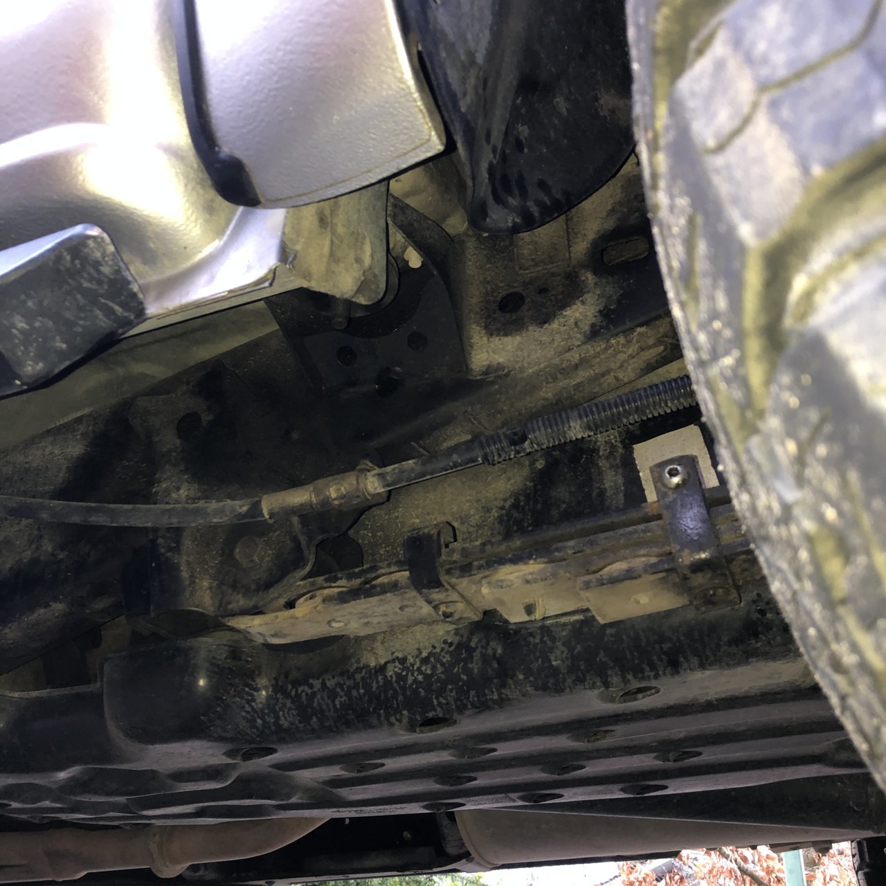

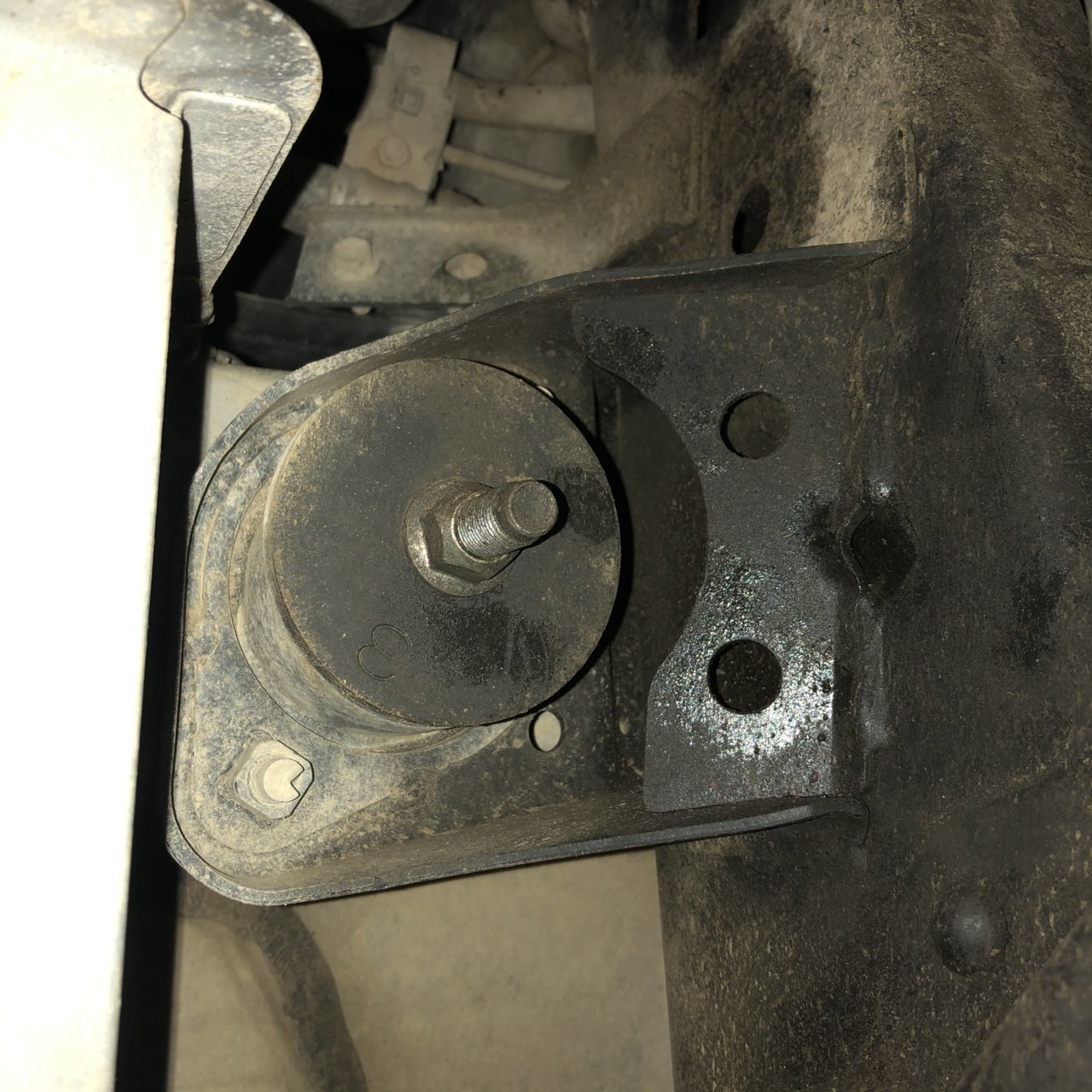

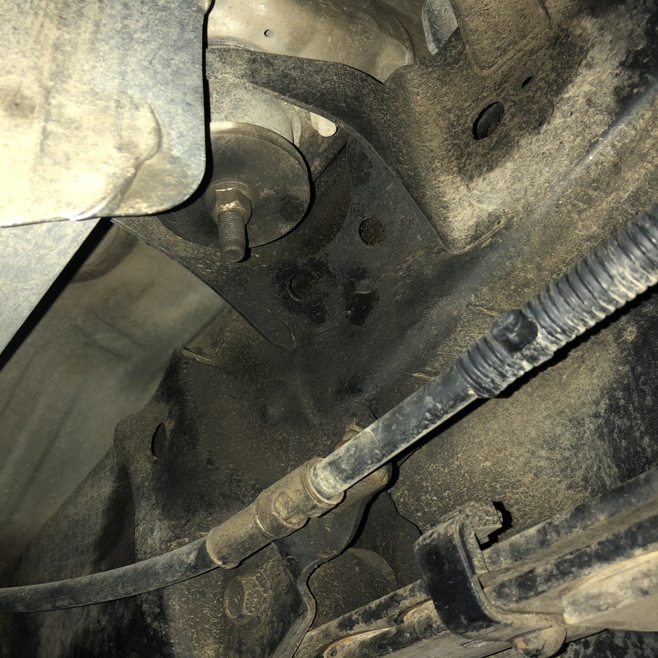

  11. Mar 10, 2020 at 7:02 PM
    Stocklocker
    Stocklocker Well-Known Member
    May 15, 2017
    #219125
    12,732
    17TRDORDCSBAT
    Here you go sir. Pictures shown zooming into location. Easy to find and check. Should be good and tight.
    FRONT CAB MOUNT:
    REAR CAB MOUNT:
    a400ryan, eurowner and K-Rocca like this.

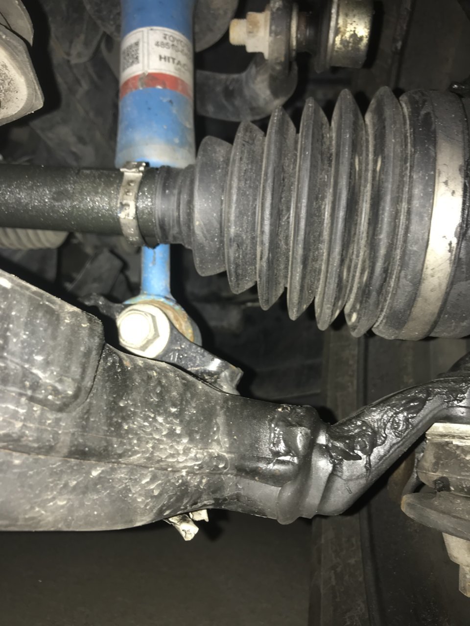

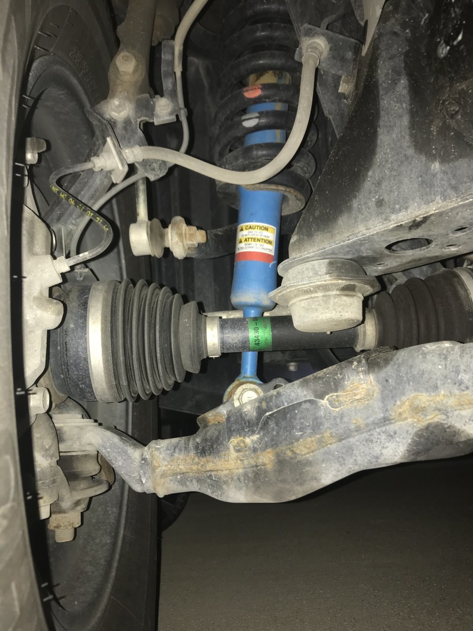

    Update: I crawled under the vehicle and checked the passenger side cab mount. It was plenty tight enough, so I don’t think that was the issue.
    However, in the process of checking the cab mount, I noticed the axle boot (I’m assuming the one that the dealer was supposed to fix) is not clamped properly and is leaking a good amount of grease. You can see the build up below the axle boot and can see the clamp off the left, not even on the boot. I’m assuming that’s my issue.
    First picture is of the leaking boot on the passenger side front wheel. Second picture is the driver side front wheel for comparison.

  14. Mar 11, 2020 at 7:16 PM
    Skydvrr
    Skydvrr IG: @kalopsianick
    Sep 13, 2017
    #229889
    12,654
    Nick
    YMH
    Black '17 OR
    Yup. CV clicking. I'd be pissed at the dealer.
