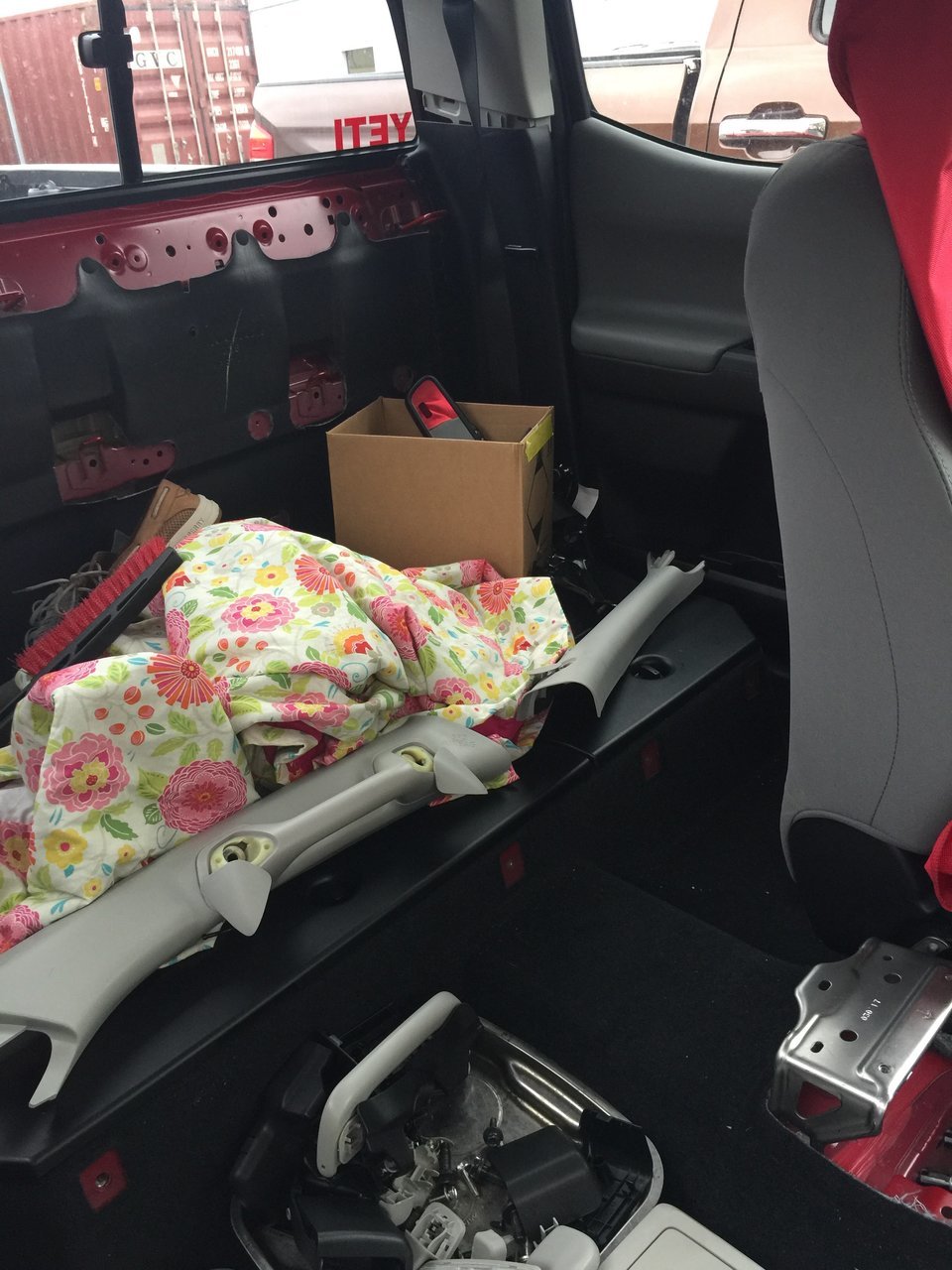

    My issue was a noise when driving on any road condition. It sounded like it was coming from the upper console. It didn't matter if it was a super smooth road or offroad, it always made it. To me it sounding like a static/rattling noise. Took my truck in 2 weeks ago for the dealer to check out. They figured out what it was (loose reinforcement bar in roof I believe they said) and said it would be a 2 day repair, well 2 days turned into 2 weeks. Actually went to pick up my truck finally tonight and when I got in it was dead, the general sales manager apologized and had someone jump it.
    After that I proceed to get in the truck and realize my front seat is messed up. Felt like you were sitting on a stool that was not even and was rocking back and forth. Obviously i was extremely mad at this point and they offered to keep it overnight and fix the seat first thing in the morning, detail the truck for free, and personally deliver it to me tomorrow.
    And BTW if anyone has them fix this expect your interior to be gutted. I went by to get some stuff out of it when they told me it was gonna be longer than 2 days and they had all the seats out of it, headliner out, pillars out, center console out (This is why my seat was messed up probably). They said they had to take all of that out to get the headliner out of the vehicle since it is so large. So good luck to you all if you get this fixed and hopefully your experience is much better than mine.

    This picture is not so great but you can see how much they had to take out of the truckIMG_4804.jpg
