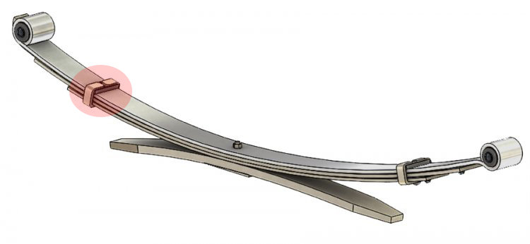

    My 2005 is making a similar noise and from what I can tell it's the alignment tabs on the rear of the leaf springs.
    That being said I haven't bothered trying to find a fix yet because next week I am having the TSB done.

    I need to do my TSB but too lazy to remove my AAL and then install in the new pack. Plus time is very rare for me right now since I'm moving in 2 weeks. I'll look at mine, thanks for the tip.
