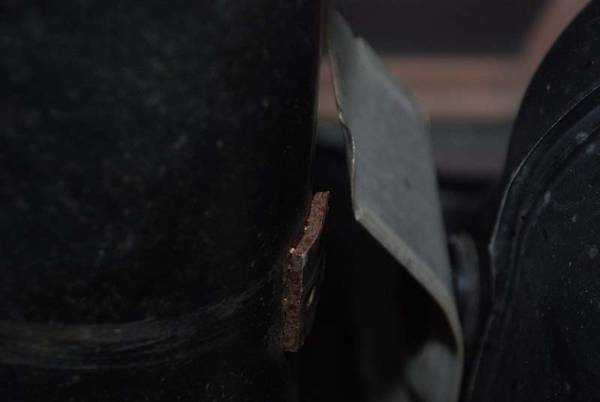

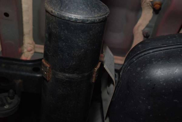

    Crawl underneath your truck and look for this:
    Thats the shielding from the gas tank bent back into the driveshaft. It caused a squealing noise for me. It happened when I rolled through a big puddle on the way home during a downpour. Could be your problem.

    What did you do, just bend it back with your hands?

    Yeah Its really lightweight sheet metal. I guess I'm not the only one who's had this problem before, so I thought I'd throw it out there.
