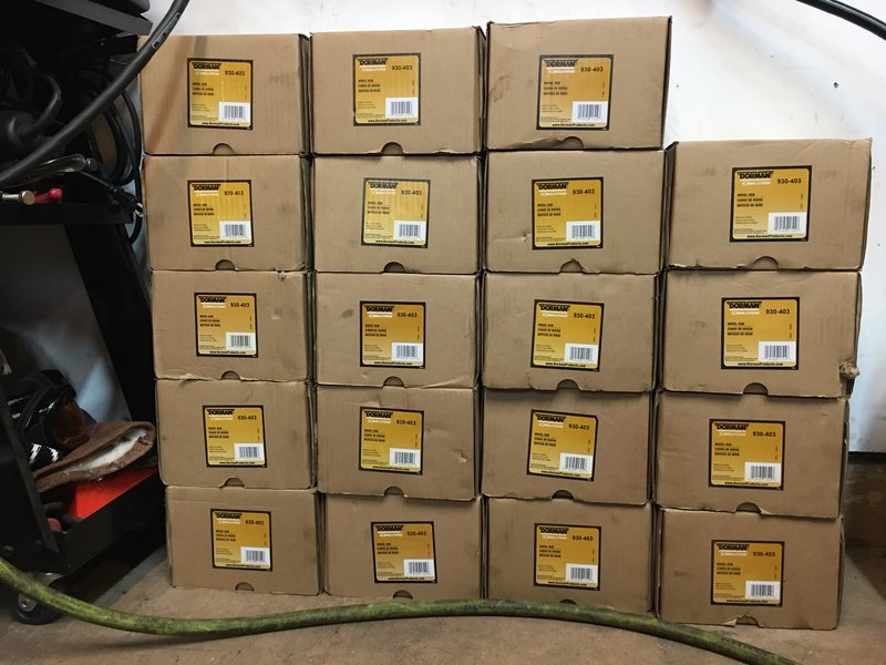

    A good time to purchase. My volume is a lot lower right now due to my week off at my 9/5 putting more time me to building a
