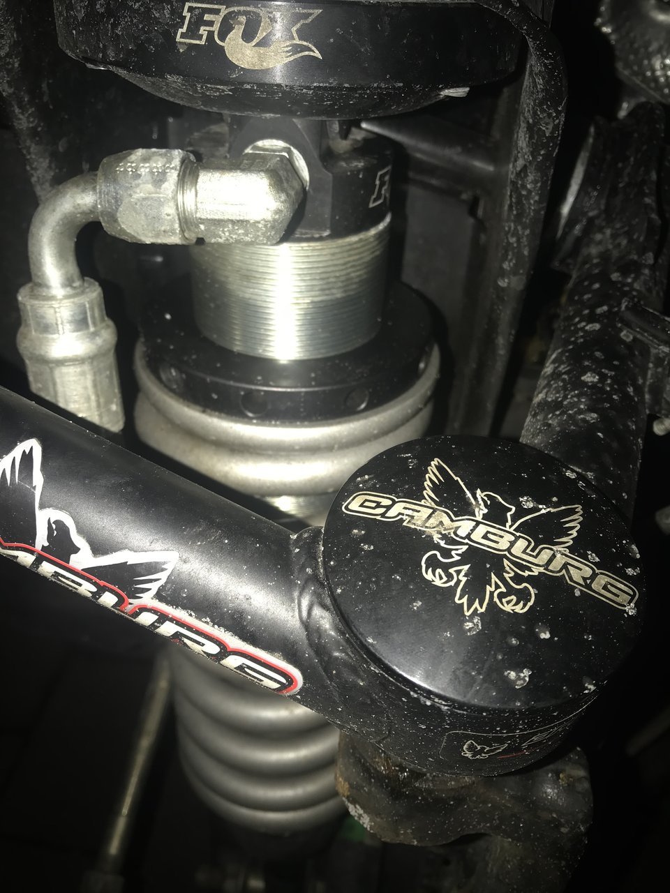

    Maybe you need to step up to a 650lb spring, assuming your running the stock 600lbs. That should get you the height you want with less preload on the coils. And you could remove the 1/4 spacers.

    Hmmm so if I wanted to do 2.5” instead of 2”, I should get the 650lb springs and that should take care not to have noises and give the shock room to perform better offroad also at the 2.5”?

    Well if toytec is correct then the 3rd gens cone factory with 717lb springs. So using foxes 600lb springs you have to preload the coil a lot to achieve more lift. Stepping up to a 650lb would allow lift at less preload and hopefully a better ride. I can’t speak for any noises because the OP hasn’t figured out what is making the noise. It may have nothing to do with the coilovers.

    Sounds like a spring problem. Too much preload. It's not a damping problem as some have tried to sell you on.

    One thing to clear up from this thread; too many people confuse springs and damping. They're separate and do different things.
    Simple example (and not absolutely true but y'all get the idea) is a 600 lbs spring set with 0 preload will move at 600 lbs.. you crank it up to the sky just because you want a lift that says Fox on it you increase the preload in the spring and make it harder for the spring to move. If you add 200 lbs of preload you're over stock @ 800 lbs. That means before you even get into the stroke you'll have to have more force to begin moving the coil. NOT DAMPING.
    So when the OP said he was getting a thunk, i believe it's from him putting too much preload on a "soft" spring. That would also explain why it goes away at higher speeds and rides like crap.

    Couldn’t agree more, done research and would agree with you. I believe you are correct that many are seeking an excessive lift from a fancy brand.I have these set to what feel is an acceptable level? I cranked them up roughly 7 threads. Close to an inch. Currently I can’t go any lower with my tires and wheels to test the theory of going lower. Could be that as others have mentioned, the fox setup doesn’t fair well bing cranked on. Unfortunately I don’t fall under the more money than sense category so it will be pretty painful if I have to suck up as a loss.

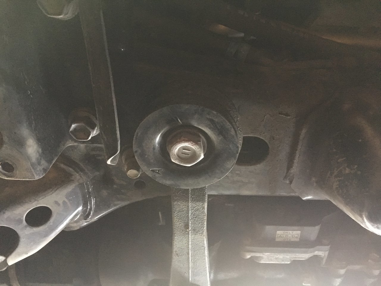

    Mine thunk and I haven’t adjusted them yet. Stock height from Fox. :anonymous:

    I checked my rack was super tight, over 130 ft pounds. But I did find the the front diff mounts were loose about a 1/8 of a turn. I torqued them and the truck doesn’t make the thunking sound any more.
