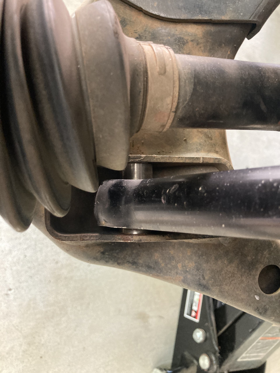

    I just bought a 2021 and put the 2.5 fox shocks on the front with 650 eibach springs and icon tubular uca uniball, when I hid harder bumps at any speed I’m gettin a loud chirping squeak, anyone have ideas?

    Not sure about the above but I've got 0-3" 2.5 RR non-DSC with SPC UCA. I have them set to 21" total height as per accutune Offroad recommendations. Ride is exceptional and everything I would expect from Fox but I am getting the "clunk" noise at low-speed bumps and chatters. I've re-torqued everything a few times with no change. Sounds like it's a common side effect but has anyone solved this yet?

    Check your front sway bar to see if its hitting skid plate or anything. That seems to be the common issue

    I have the sway bar removed. Based on sound and feel I suspect it is metal to metal contact at the LCA bolt or just the coilover itself. Have the reservoir IFS piston ever been known to make noise?

    The shocks should not make any weird clunk noises if they are properly charged.

    This is likely part of the problem - lower eyelet spacer was incorrectly installed from Fox (wide end should be forward). I was getting some contact with the LCA mount but nothing crazy. Pulled and re-installed and the coilover definitely sits in a more natural position now. Still getting the slight chatter at low speed bumps.
