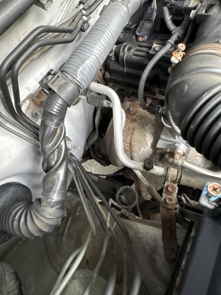

    Make sure the exhaust connection between the header collector and the entry of the midpipe (the one with cats) is tight and not leaking. Ive had an exhaust leak here before and it caused a rattling/marbles in the engine type sound while accelerating that sounded very similar to spark knock.

    image.jpg is this what you’re referring to?

    Yes, that’s the one
