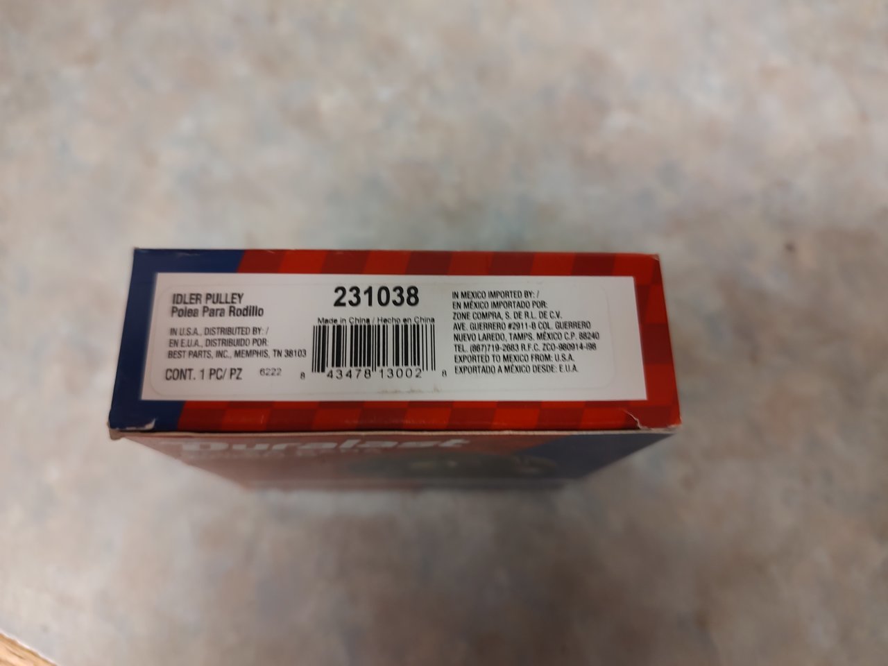

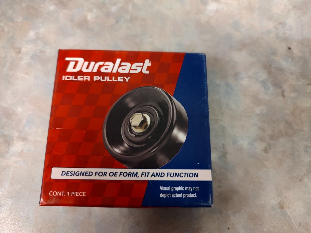

    Is the Duralsat pulley 231038 @Red_03Taco showed what you are referring to?

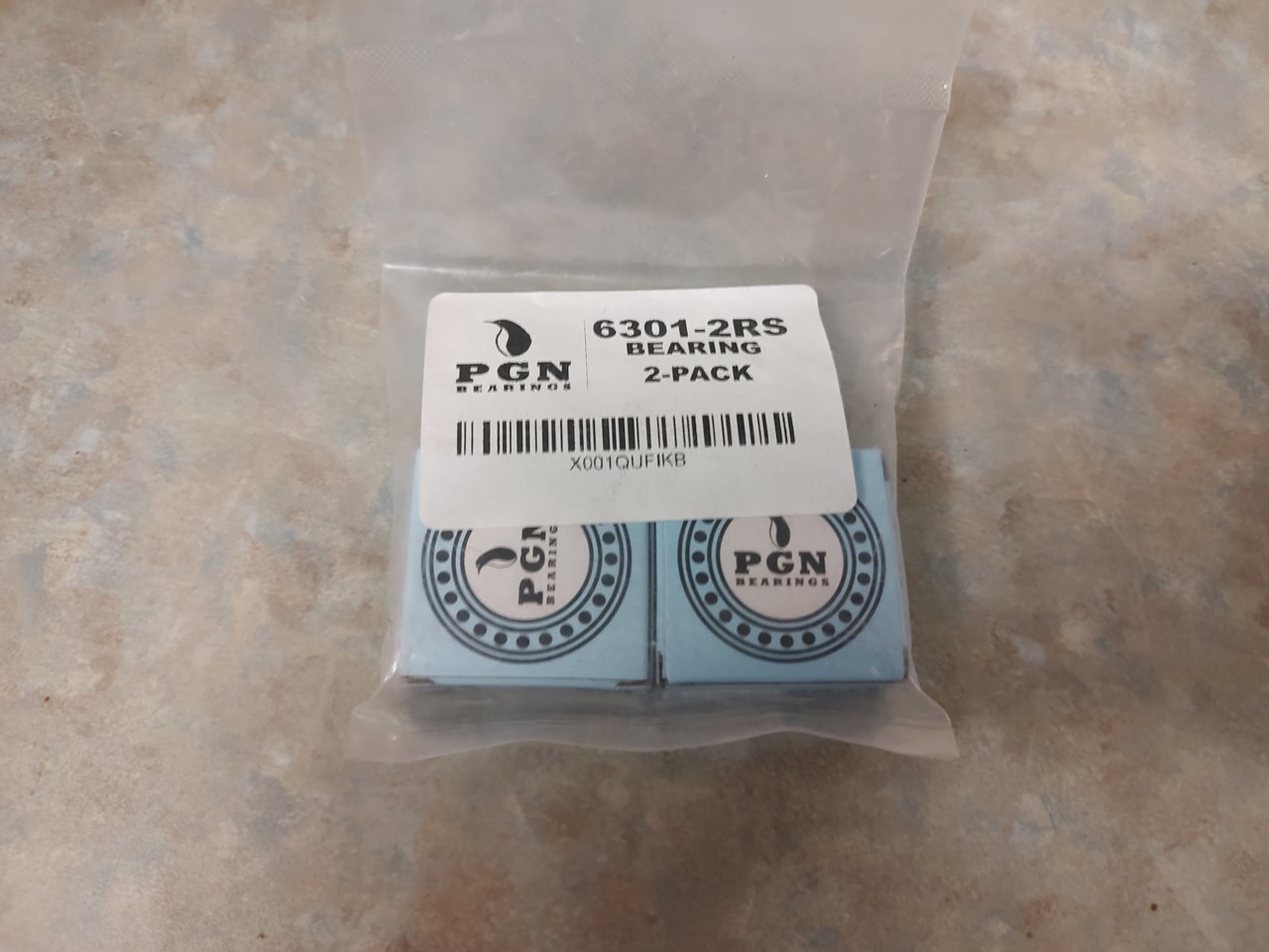

    Yes, he was referring to that pulley. The Duralast one may not be on par with OEM quality, but it's decent and purportedly uses the same 6301-2RS bearing as OEM.
    Changing it is a breeze. I believe it's (2)12mm nuts, (might be 14mm). Just loosen the front locking nut, then loosen the adjuster around back to put slack in the belt, so the pulley can be removed easily by hand. Then place new pulley in, tighten adjuster till belt tension appears appropriate, then tighten front locking nut. 5 min tops. Here's a video to for visual aid:
    https://youtu.be/8ehoRUcGsV4?si=IUYNsWcAM0vr4ncb
    Edit: remember to swap the dust shield (large round convex washer looking thing on the front of the idler pulley, located between the locking nut and the pulley) from the OEM pulley to the Duralast one.
    Also save the OEM pulley housing and when the Duralast one craps the bed, just replace the bearing on your OEM idler pulley.
