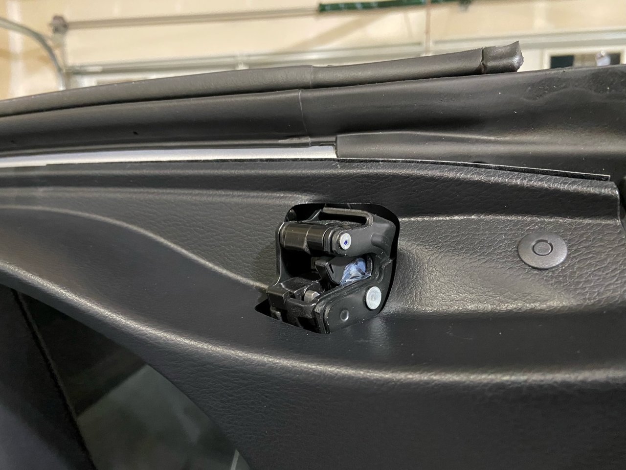

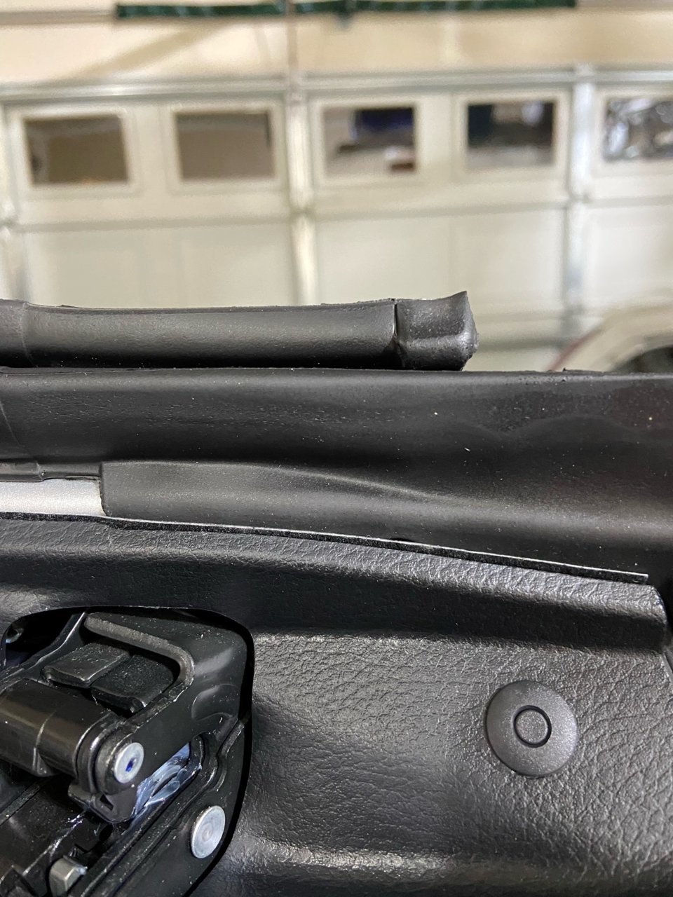

    All good suggestions to try. I've tried a lot of things without lasting success. I am able to isolate my rattle to the top corner of my access cab door panel. When I've pulled my panel, the rattle has gone away completely. Obviously I'm looking for a solution where I can keep my panel on. :)
    Here's my latest attempt, and it's been working for nearly a week, so I'm cautiously optimistic, though nothing would surprise me any longer with this. I placed a thin piece of felt tape, even with the backing still on (it won't slide down further), between the upper right corner of the door panel and the metal door. I've tried felt tape near here before, but never thought I'd need to slide the felt all the way over between the panel and the rubber part at the top corner. This has silenced by door rattle for several days. I don't know if it just adds a little space so the plastic panel isn't contacting the door or if it's been that rubber piece making the noise all along. Either way, if you can isolate your rattle to the top corner on your access cab door, this might be worth trying.

    Good luck. This felt tape placement seems to have done the trick for me. I’d tried felt tape before but never over the rubber part at the top corner. I always figured the rubber piece would act as insulation. For the record, I cut a piece long enough to run across/under most of the top of the panel. Hopefully the pics show it. Hope you can solve it!
