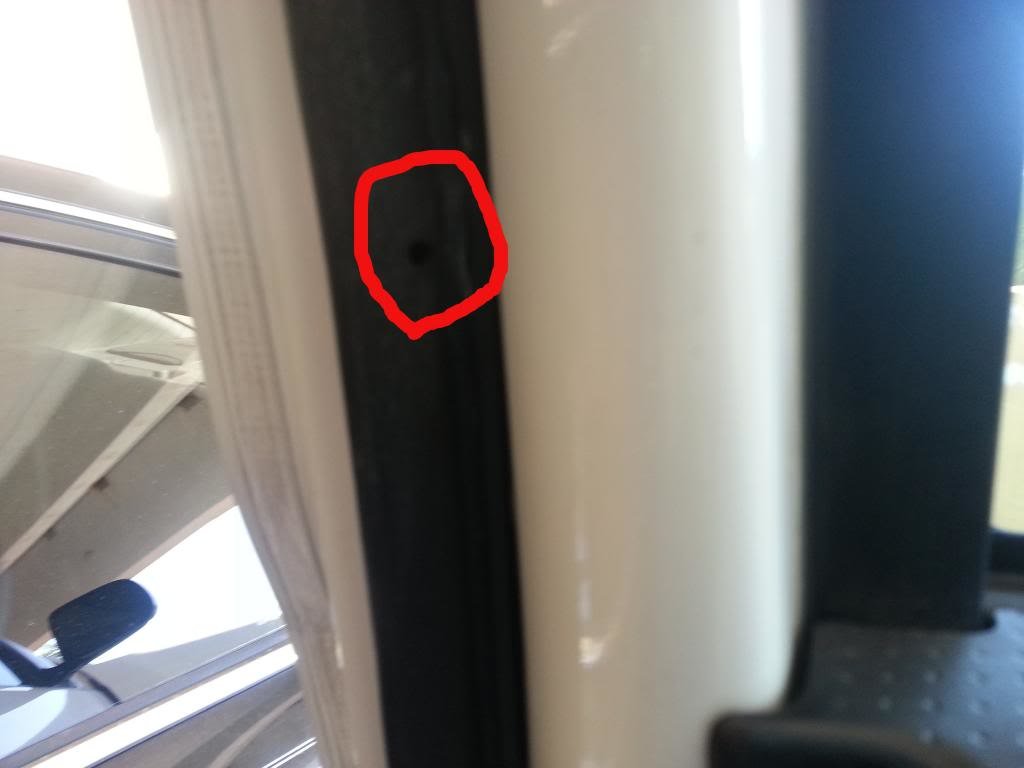

    There really isn't much to see but I went and snapped a pic. What I did is find this tiny hole, or any of them, take a pair of small needle nose or something you can use to expand the hole (the first time I did this I cut a small slit. The second time I just expanded the hole).
    b6cb49d1-d3a8-4076-9c36-bc48c473d438_zps_e6e3f6e8968149e5fd7eb3a438a8fcabc248c6b5.jpg
    Expand the hole.
    Put some lube on the drip line. ;)
    And just start feeding it into the door seal. Once you get the line in there you can remove the needle nose and then just slowly force it up in there. From the feeling of it you could run 2 sets of drip line and I think it would work as well. I'm going to try and pull it out and run it through the entire door seal and see if that fully fixes it.
    I used about 2 feet or so and just feed it up and over the curve of the entire window.
    And yes I used irrigation drip line to fix this. Also I've used this method on a hood seal as well and it seemed to help a bit.
    Sorry for the shitty pic, couldn't get it to snap right in the parking garage at work.. I'll try again at home to update it.
