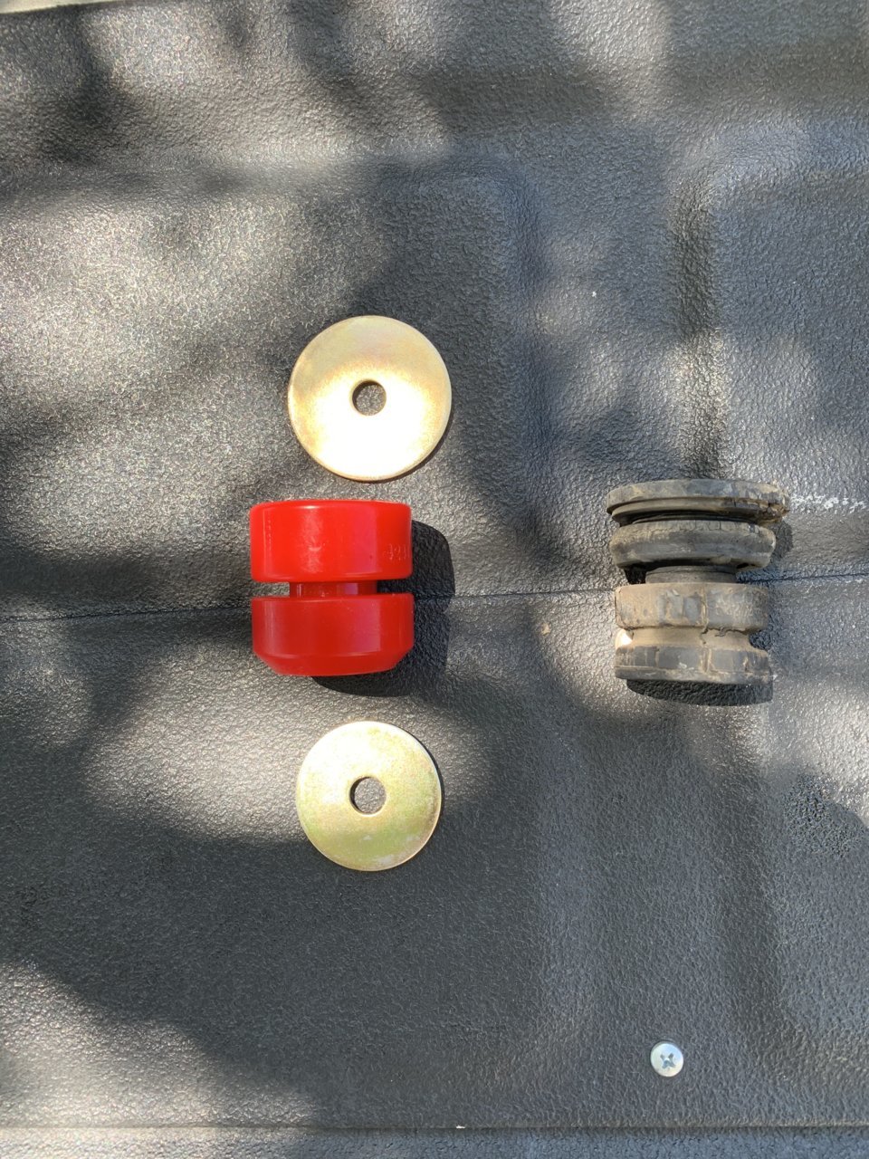

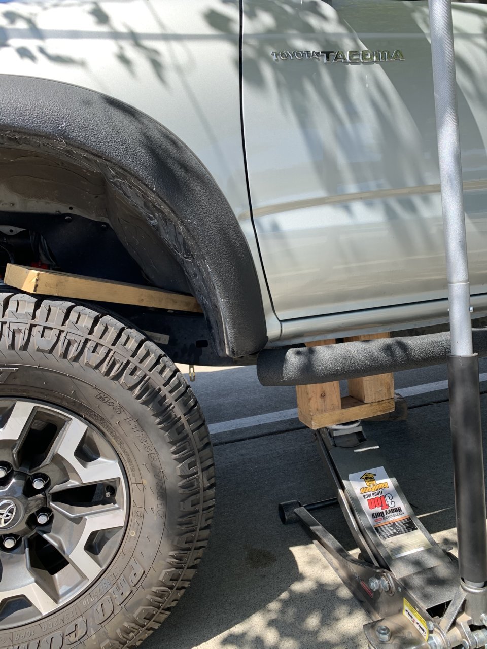

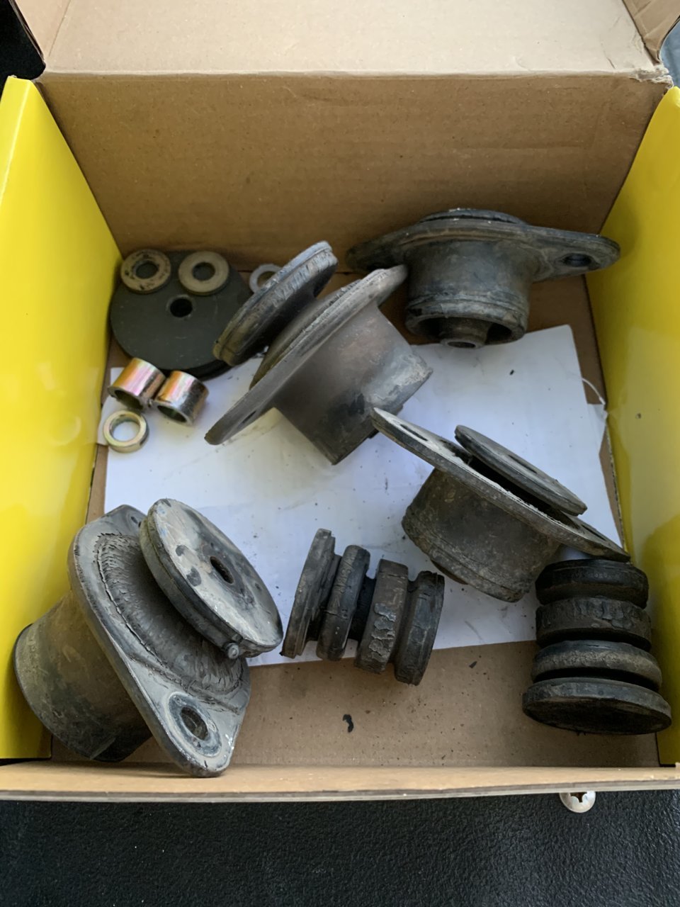

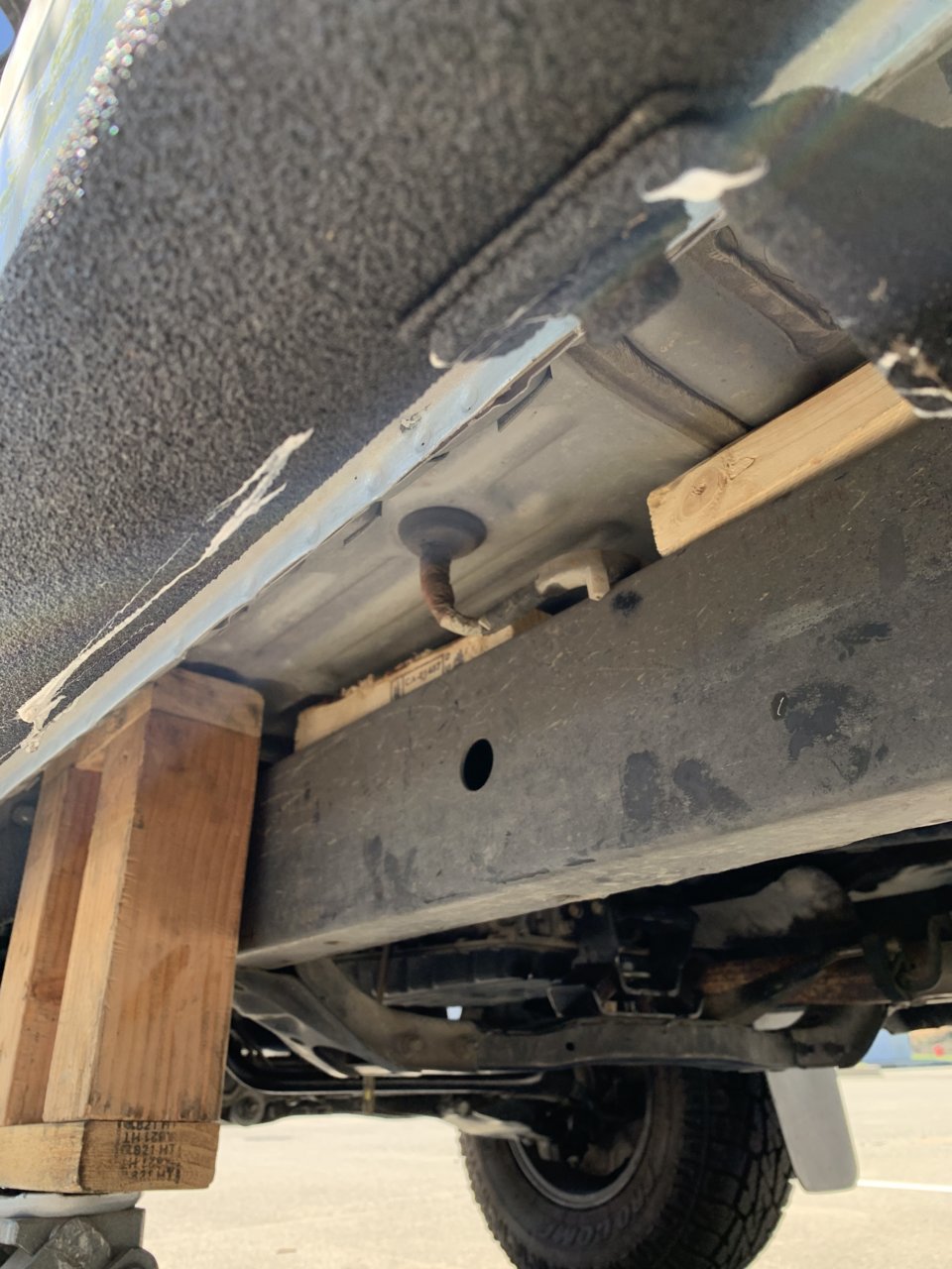

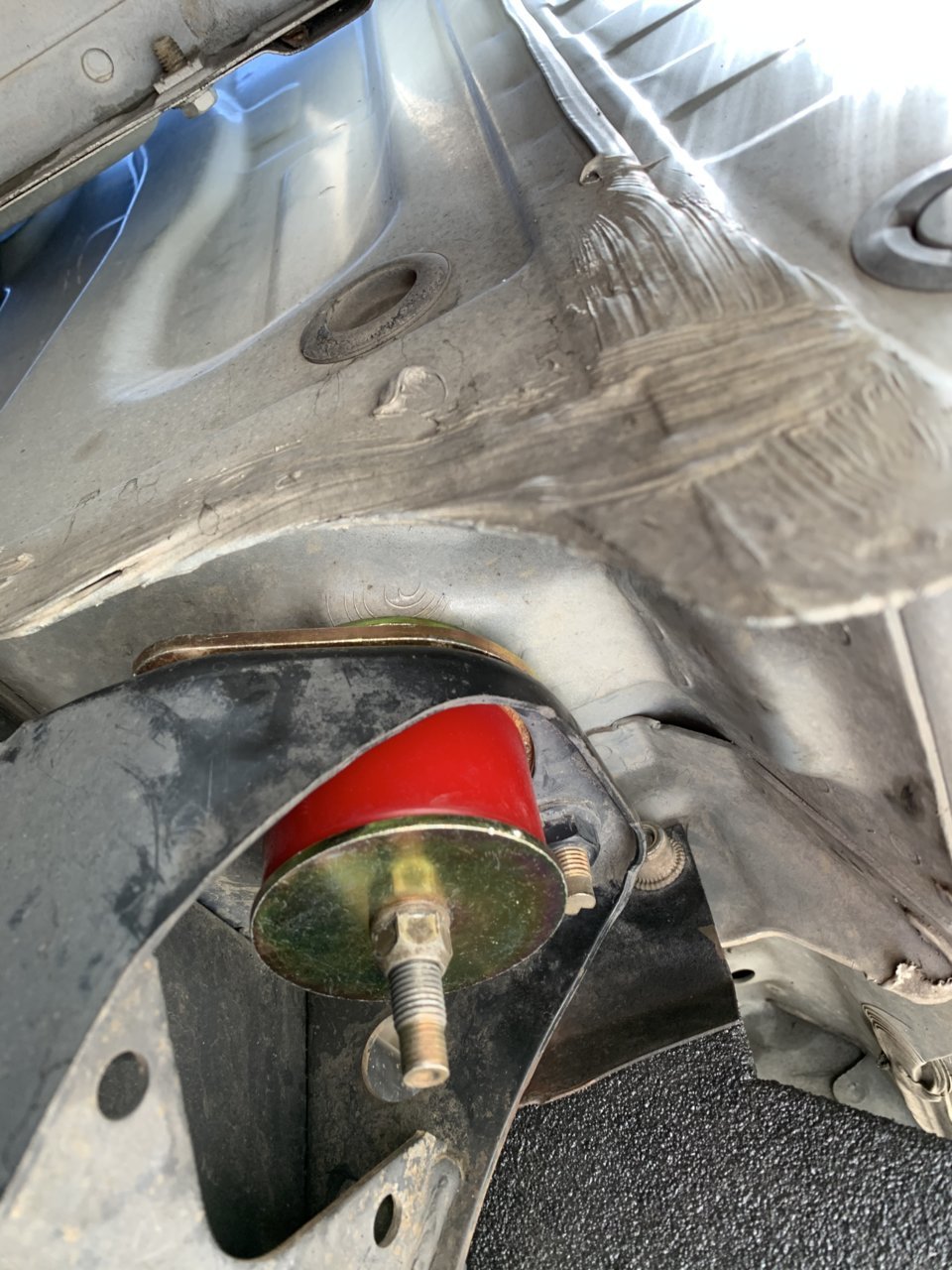

    I changed all six of my cab mounts with the vehicle on the ground. I used a floor jack and several pieces of wood placed between the frame and the cab to keep my hands attached to my arms if something slipped - no close calls happened. If you do change any or all of them I don’t think you’ll *need* a lift either. What matters is disconnecting what needs to be disconnected before you start to jack the cab up off the frame. For my 1st gen that was shifter linkage, fender liners so they wouldn’t tear, hard brake line brackets that go to the frame (brake hose connections stayed, no fluid loss or bleeding) possibly one other small thing but I can’t recall. It’s doable even if it sounds like a lot. Here’s a before and after of the front radiator bushings. My originals weren’t even grenaded yet but I was on a tear to replace all 20 year old rubber parts. I went with a full energy suspension replacement kit. And after I’ve done this I now see when someone’s body lines are off even if it’s minuscule like an 1/8 of an inch.
    *apologies to anyone in the rust belt that wasn’t ready for that clean frame porn. Haha this CA truck has had it too easy.​
