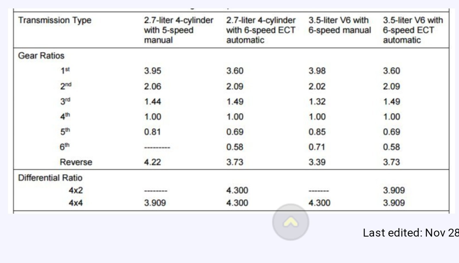

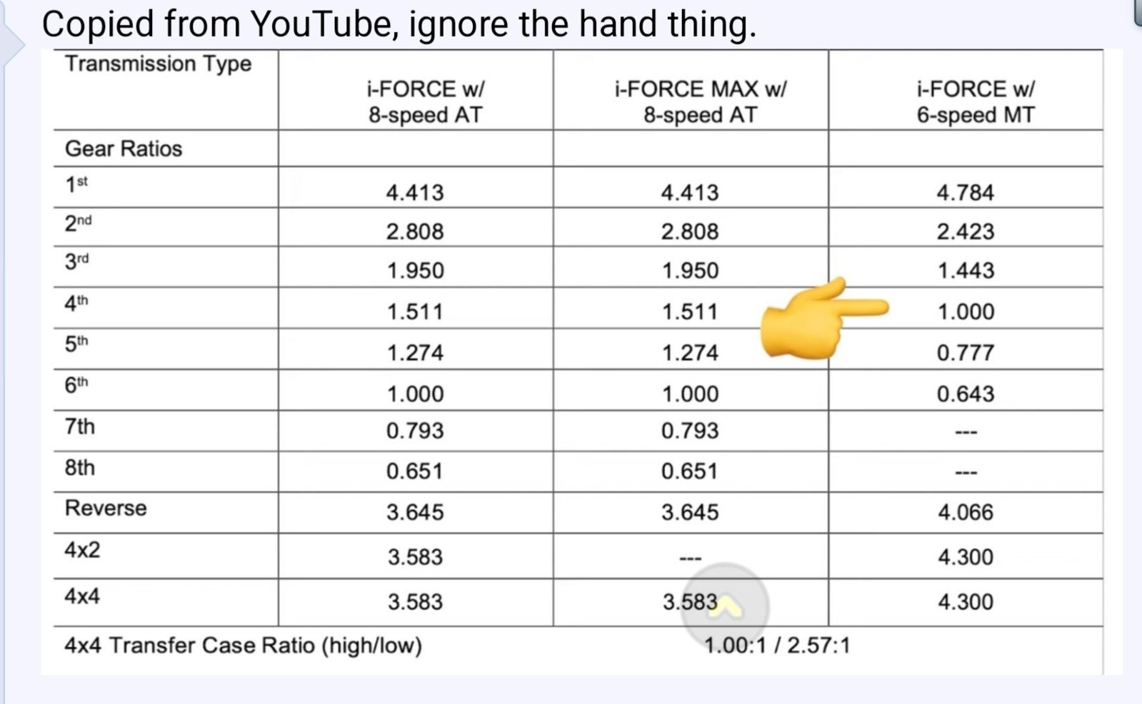

    Thank you for the feedback recommendation. I'm definitely leaning 255. The new gen Taco has more room in the wheel well vs 3rd gen so 255 won't quite fill it in the same but I'm thinking efficiency over looks. Plus a 255 will fit on the skimpy spare tire rim as factory 4th gens come 265 70 but a 245 spare and if I'm upgrading tires I may as well do all 5.
    I know this is a Nokian thread but I found the gearing changes between 3rd&4th gens so I'll post for reference. 6MT for me.

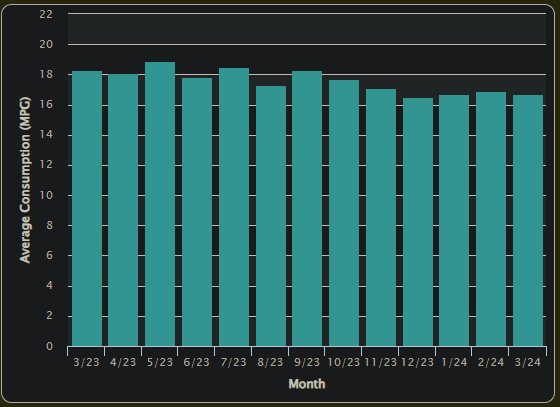

    Yeah. After 15k of puckers with the Nokians, I'm still getting used to the feeling of traction in the wet. Note that it was my wife telling me to ditch them from the right seat.
    No changes that I can verify yet. XL rated. I'm a believer in SLs or similar sidewalls for the Taco.
    Friends love the Baja Bosses. I couldn't go there for the LT aspect.

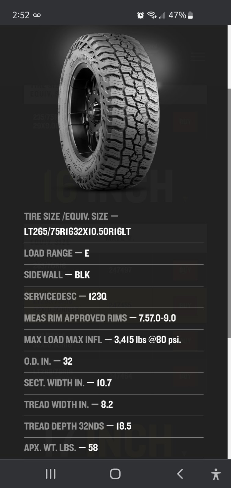

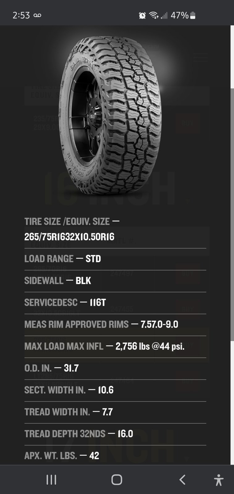

    Ya that sounds like a nightmare. Glad to hear you can enjoy driving in the slick again.
    I'm looking at SL or XL as well.
    It's pretty substantial 16lbs jump to LT in the Baja Boss AT.
    I screengrabbed these in the r16 spec but my 17's are similarly gapped.
