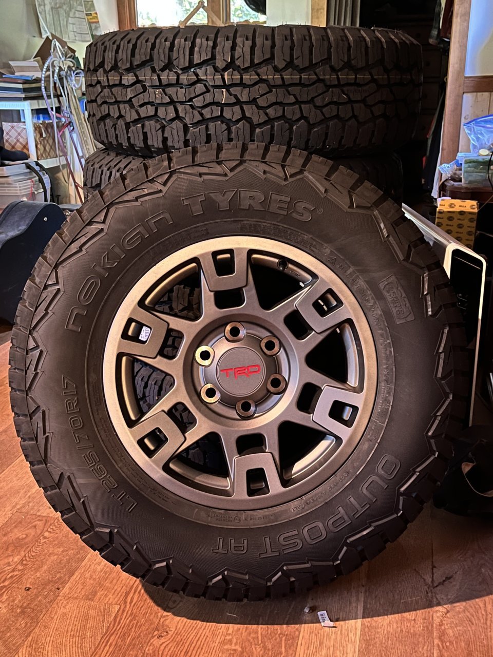

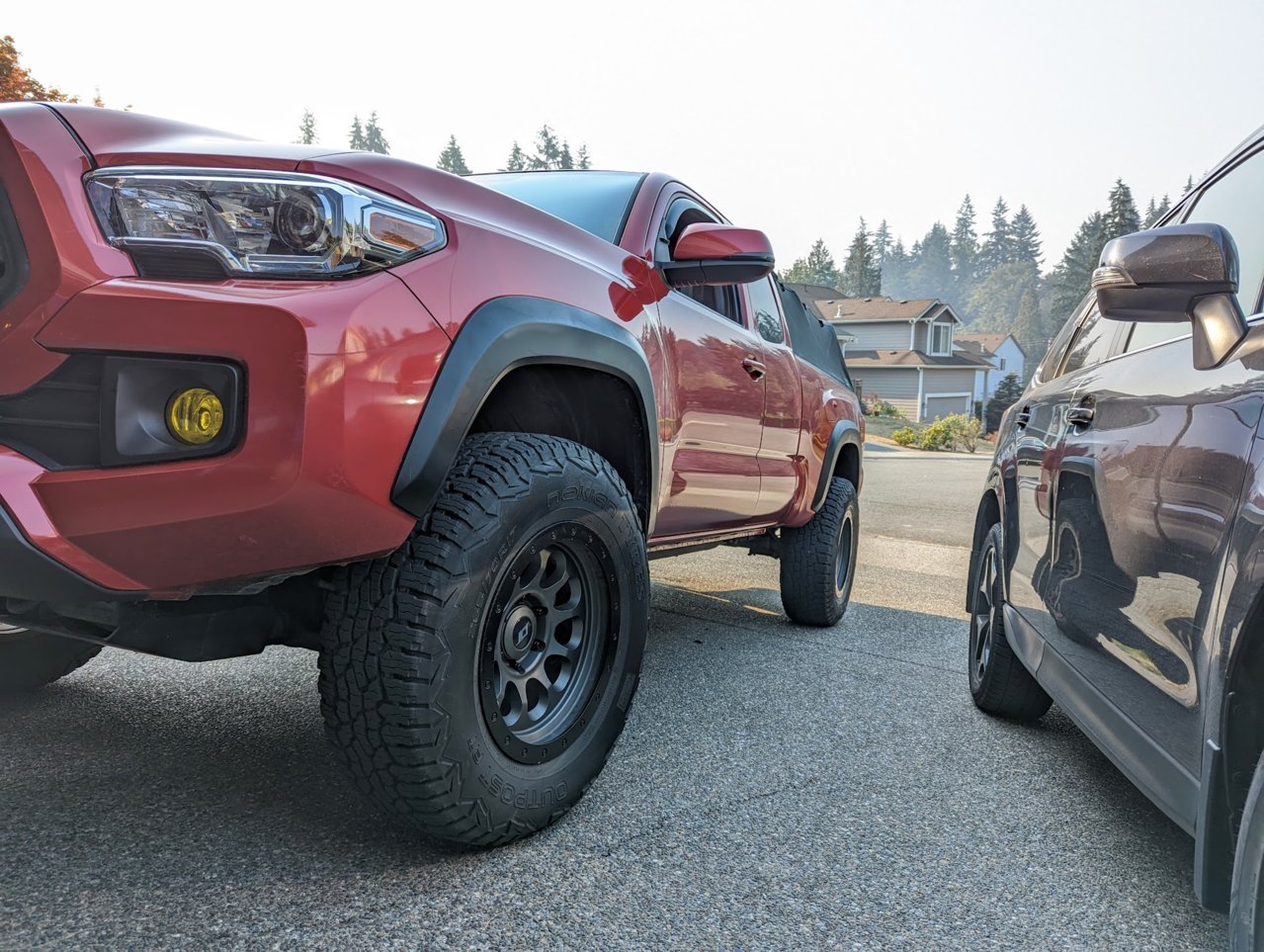

    Hey, Folks.
    With the dry season over here in the Seattle area, these tires are making me scratch my head. They have been great in the dry and really good off road. In the wet, they seem to be struggling to hook up when accelerating. And, someone asked me about wet braking. I gave it an aggressive stop and they seemed to go over the traction threshold a bit early. In all, they are very predictable when they slip and wet cornering traction seems quite good when messing around.
    I'm trying to figure out if my memories of the Wildpeaks are nostalgic or not and want to be able to recommend the Nokians. The other possibility is that I had loftier goals from the Nokian urban legend.
    Anyone else out there hustling these in the wet and can confirm or deny my suspicions?
    They're looking spooky good on new wheels.
    PXL_20221015_181800313.jpg.

    What wheels were on there previously?
    Additional scrub on the new wheels will cause a toe out condition under harder acceleration and braking...

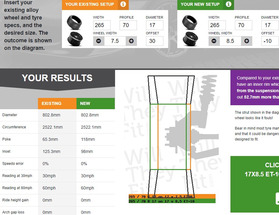

    They were stock Sport wheels. 7.5in +30mm to these at 8.5in -10mm. But, this was noticed before the swap. Mainly the slip when accelerating.
    Honestly, the new wheels with about 4.0in more width overall have noticeably better handling. I was not expecting that.
    Neat visualization: upload_2022-11-2_8-14-30.jpg

    Not surprising...
    The additional scrub is usually more noticeable under hard braking, as more force is applied than through acceleration. Weight transfer to the front is also increased, as additional scrub lowers the effective spring rate, making the rear end lighter.
    I"m not trying to dismiss the performance difference you are experiencing between tires. I"m just saying, it might not be the complete cause.
    This calculator shows the additional leverage(scrub radius); 40mm in your case. The toe-in spec of +0.05 infers a stock scrub radius of maybe 1/8"; 1/4" at most. An additional 40mm is significant. Handling would be improved because wider track is inherently more stable. Turning would be easier(especially low speed), as the tire is doing less pivoting in place and more fore and aft through through the increased steering arc.

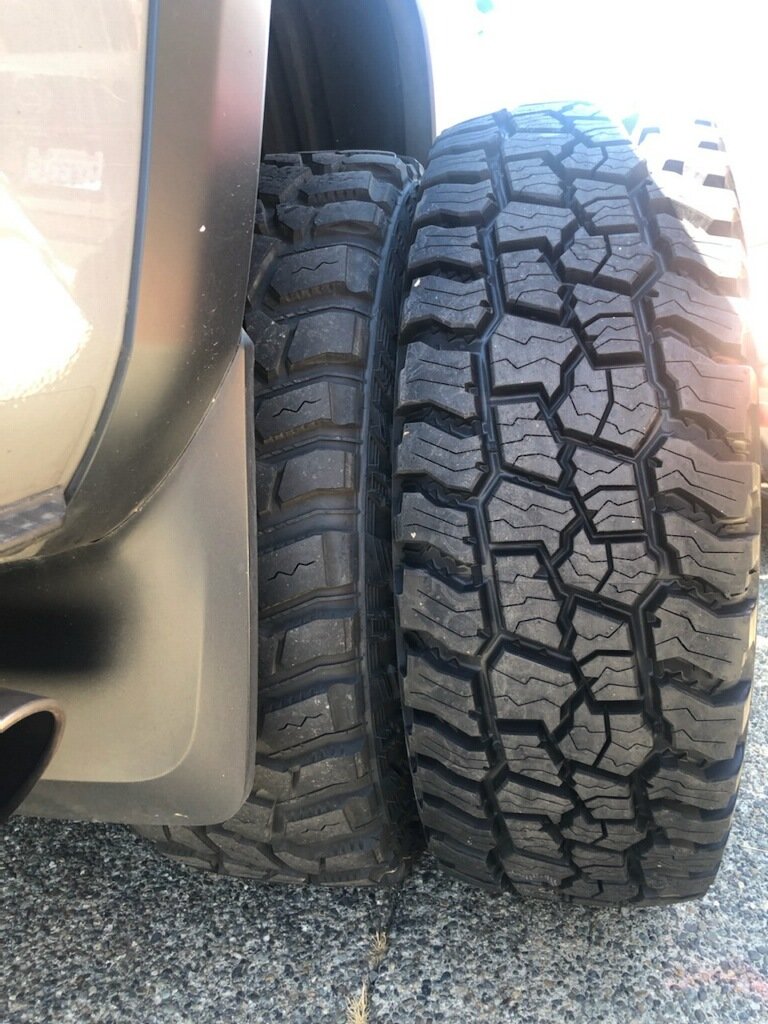

    The Falkens were good, just not worth the price now, IMO. A friend just got the Baja Boss ATs in place of STT Pros. He likes the volume reduction. They are running a larger diameter than expected by a good bit. More trimming is needed.
    Also look at the Cooper Rugged Treks? Those were my fall back.

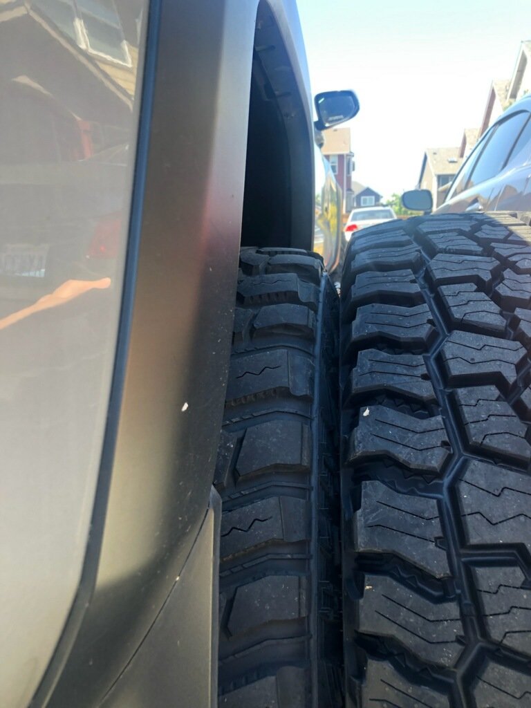

    BBAT mounted:

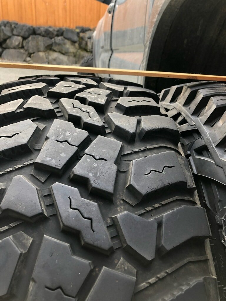

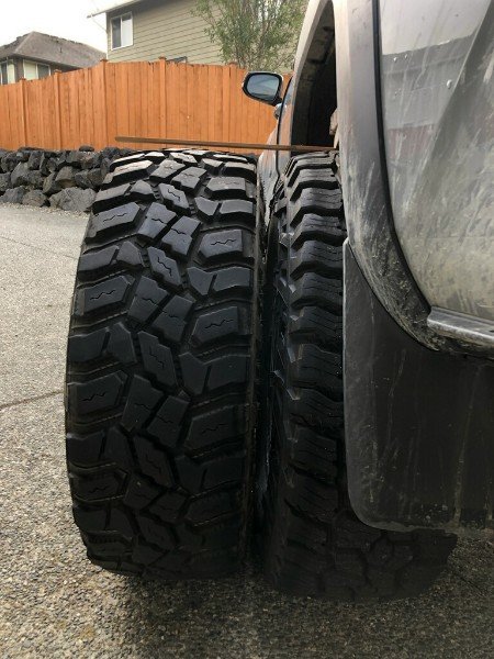

    BBAT not mounted:
