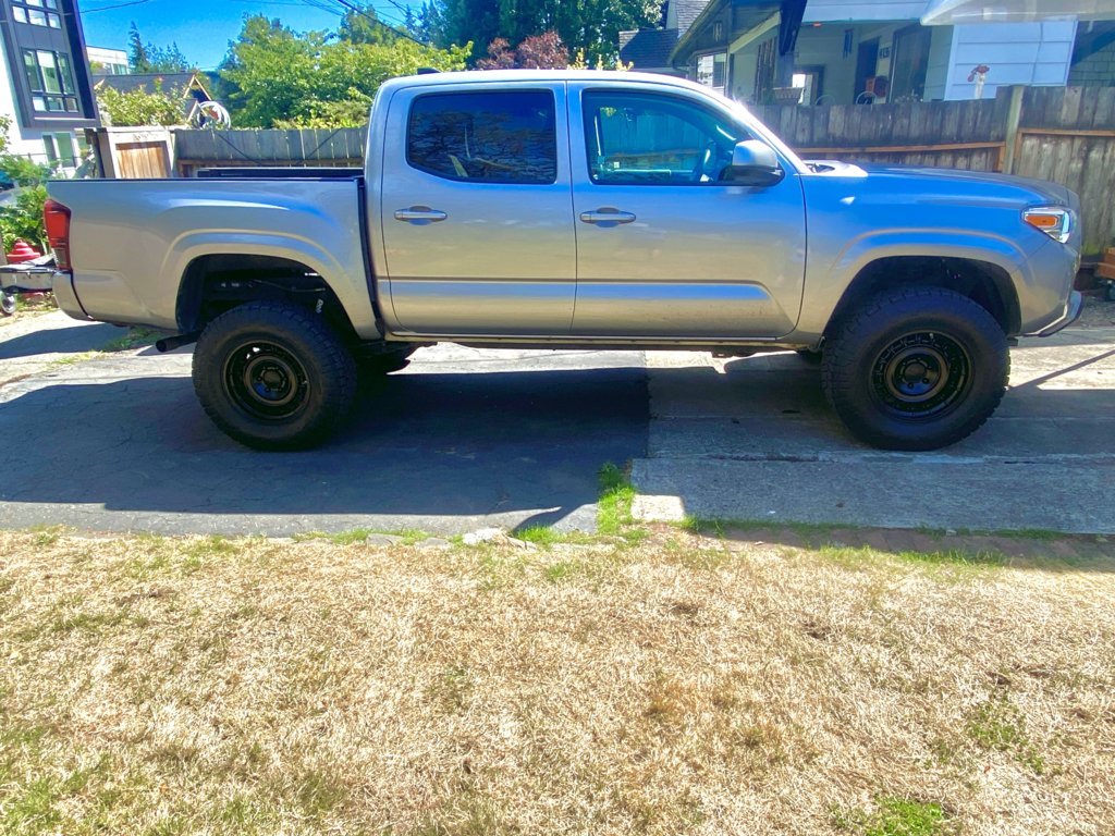

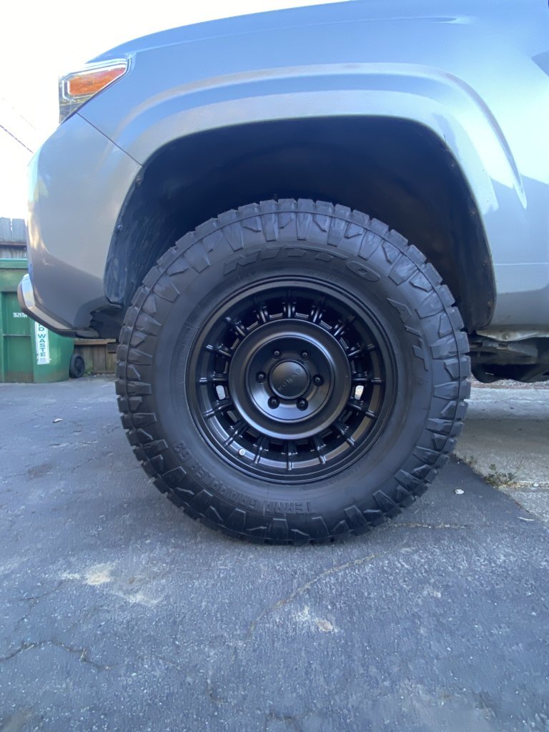

    For others getting these wheels, the nomad lug nuts don’t work well with my stock Tacoma wheel studs (not enough thread engagement, ~5 full rotations) but Gorrila lug nuts (as recommend) with threads that extend beyond the conical interface do work well (~9 full rotations). These are the ones I got:
    https://www.amazon.com/gp/aw/d/B00SF8FF86?ref=ppx_pop_mob_b_asin_title
    502SB wheels | 17x8.5 | 0 Offset
