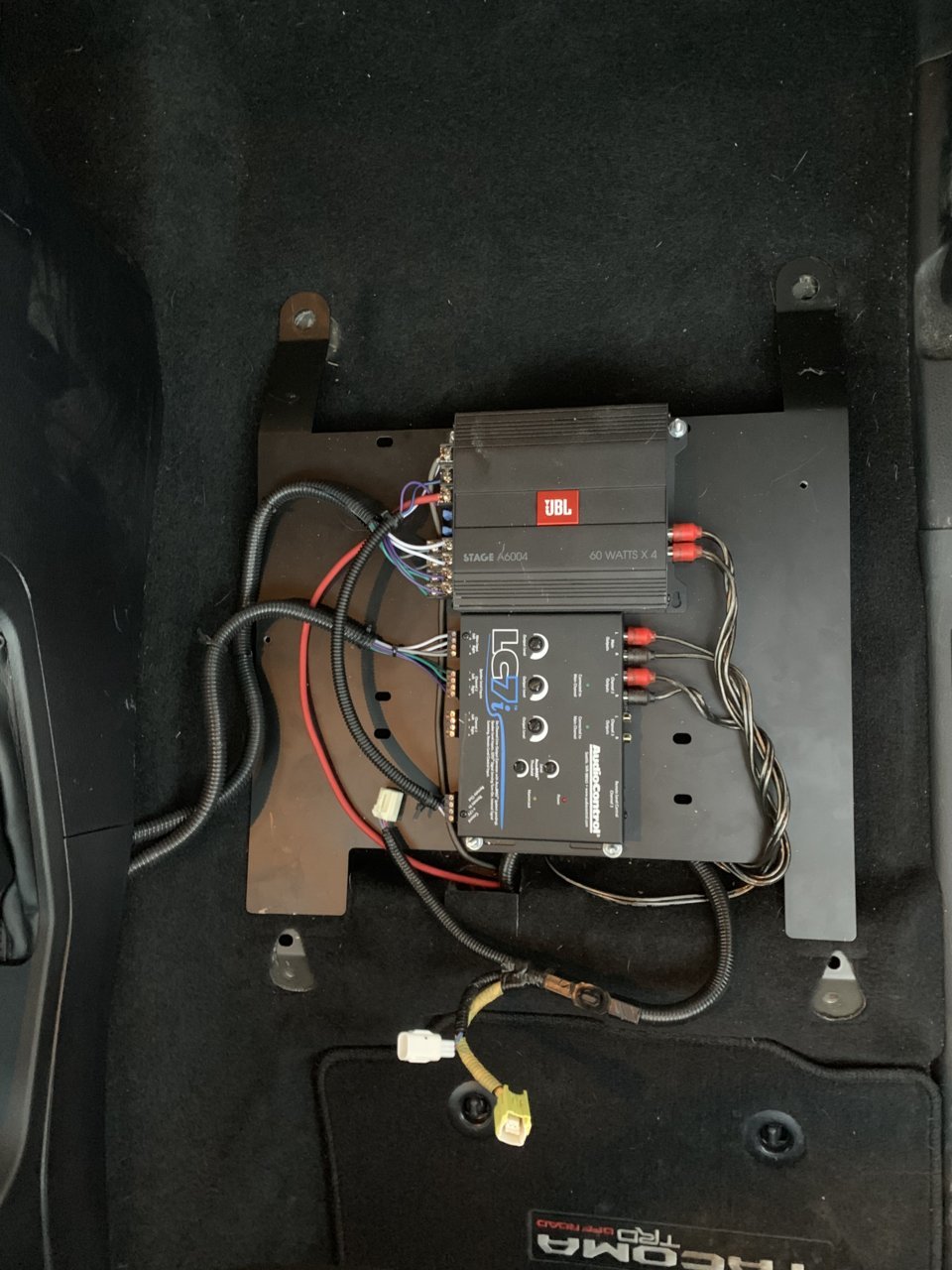

    Final step: Installation. Like I said, I am not an audio expert, so I lived off ********* YouTube videos. I have attached a photo of the wiring I did to the LC7i and the amp. The only thing that I couldn't find in a ********* video was the ability to bridge to 12V, Ground, and Remote from the amp to the LC7i. This allows everything to come on when the vehicle starts without having to run those wires off the back of the head unit.
    All-in-all I am very please with the outcome of the upgrade. It will take a week or two to tune the LC7i and the amp to your liking so don't get frustrated. I was in this whole setup for around $850, which is still cheaper than the $1750ish JBL package.

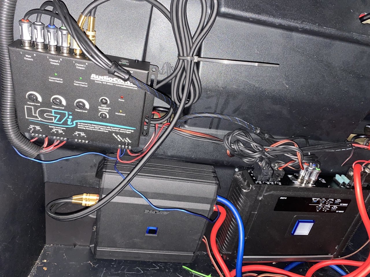

    Just did the same. I ran new speaker wire all around. Just tapped into the radio outputs.
    And one day I will clean up the wire mess. Just finished putting in the 12” woofer .
