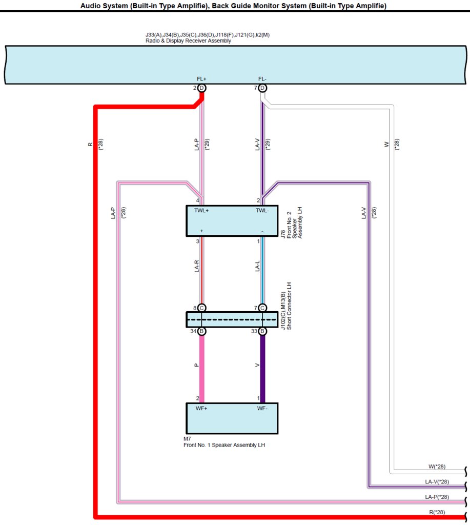

    Does this help sort out the series vs parallel?
    Also there were molex adapters in between the door and the cab. I was not able to run speaker wire through the doors. Had to cut and splice into the factory wiring behind the kick panel.

    I can't read that diagram at that zoom level, it's too tiny. Can you share where you got that page? I'm 99% certain the non-JBL has the midrange and front door speakers wired in parallel. I ordered a midrange harness today from a certain Tacorito "tunes" shop so I can play around with it without cutting up my stock midrange speakers.
    I think the simplest solution would be to replace the midrange with another 8-ohm unit. They're not very common on the market, but Dayton makes about a half dozen different models. I might go with this one: https://www.parts-express.com/Dayton-Audio-RS100-8-4-Reference-Full-Range-Driver-295-352?quantity=1
