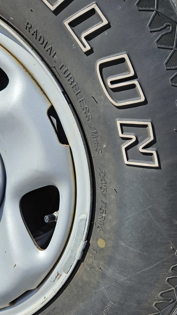

    I have 245/75/16 All-Weather tires which are ok for another year if I want. They're nothing special. Stock wheels.

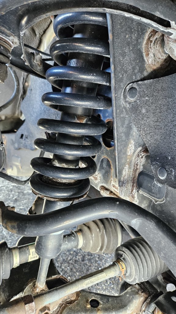

    If I consider getting a better rear suspension to handle these loads on poor roads, what is a good place to start?
    If I want slightly softer ride up front, what's a good shock?

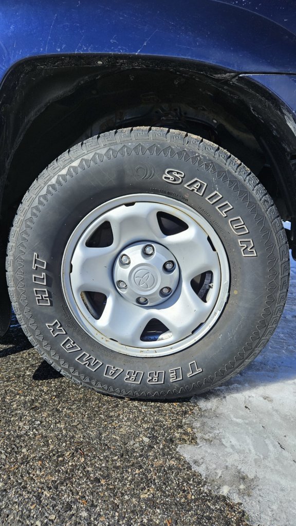

    How many miles are on your OEM shocks, first?
    And which specific brand/model of tire is on now?

    This is where I would start. When you buy your next set of tires, get P265/75-16s (not LTs). They're an inch taller than your 245s and with your stock rims, they'll fit with no trimming or rubbing. Their slightly taller sidewall *might* improve the ride a bit, though likely not enough to notice. Mainly, they should help soften the small sharp bumps just a bit. As a bonus, they do look better.

    Michelin LTX AT2 is a very nice tire. M+S rated, excellent wet pavement traction, and really good off road too. And long lasting.

    Truck is a 2013 with 65k miles. Stock as far as I know. I bought it 6 weeks ago, my second Toyota truck.

    Sailun tires, I added photos above.

    Agreed, 5000# seems a bit ambitious. Whether that's a realistic number or not, the amount of load capacity assist will depend on the air pressure you put into them. You mentioned hauling up to 500#, and there may be better solutions for you.
    I didn't advise about shocks or springs because I don't know what might best fit your situation. A softer ride is usually at odds with increased load capacity, which is why I think some sort of adjustable air assist may be the best answer.

    Oh, one more note about tires. P (passenger) rating is virtually the same as SL (standard load) which is what I have on my 2005 Tacoma. I have hauled some fairly heavy loads of firewood without any problems. Some guys prefer LT tires, but they can cause a stiffer ride and affect fuel mileage a bit.

    I think that the softer ride is less important than handling on gravel/bad roads at the end of the day. Would anyone suggest improving the OEM suspension in the front if I use the air springs in the back? I feel like it handles pretty well as is it.

    Just guesstimating based on my loads of firewood and your intended use hauling stone -- I doubt there's any reason to change anything in the front suspension. As long as the shocks are good. At 65K miles, they should still be okay, but you might want to upgrade a bit. And that's a whole 'nother can of worms with opinions all over the map. I didn't want to lift my Tacoma so I went with Bilstein 4600s (use 5100s if you intend to lift it).
