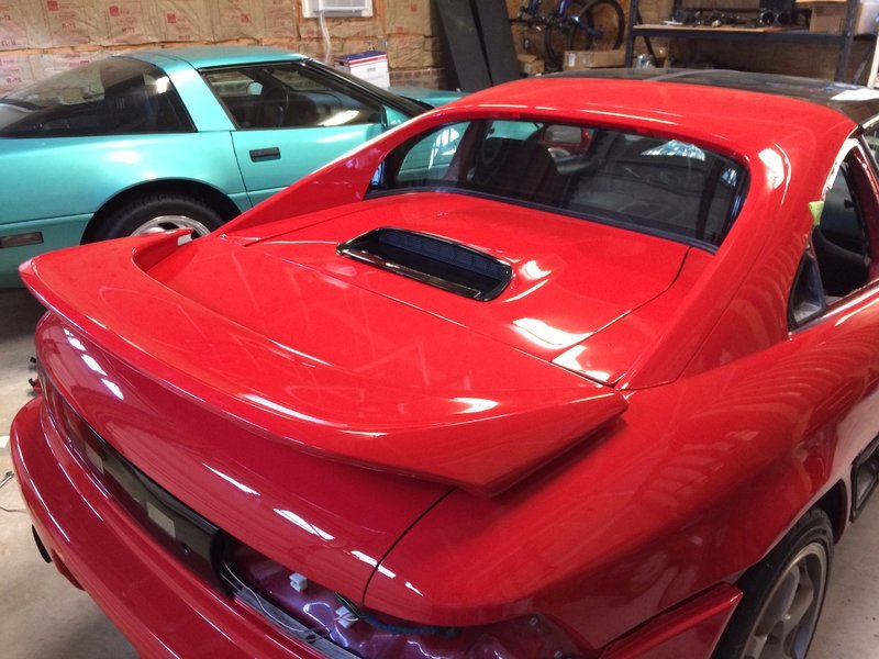

    This is what I ended up doing. Bought a hood and my body guy skinned my engine lid and the Tacoma hood. Put the Tacoma skin on my lid. Came out beautiful

    Yes it is functional...well in reverse for the mr2. I cut the back off the plastic insert. The air comes into our engine bays from the side vents and from under the car. The factory engine lid had slats for the air to escape which I always thought was ugly. This is what I came up with

    Sorry for the confusion. My post was related to the original post. Assuming you were looking for a glass hood for a Tacoma, not parts to chop, as you didn't originally specify the purpose of the hood. Thus my 'why's'.
    As an old autox'er I'm very familiar with mr2s, their balance, etc. Your cooling/trim solution is pretty 'cool' looking. (pun intended)

    Ah. Makes sense now. My body guy was originally looking for fiberglass to put it on the factory turbo hood. But we went with metal to put in the n/a metal hood
