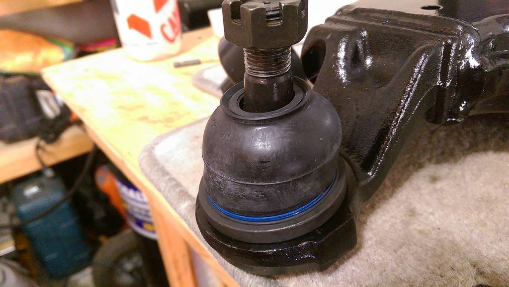

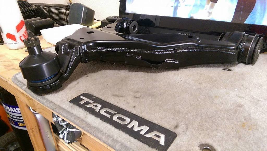

    I decided to go for it and ordered the non-OEM control arms from Rock Auto. I decided that since they were so reasonable I'd get both the left and right side. I replaced the bad one last night and got the truck aligned this morning. Everything went well with the installation and the truck seems to behave just fine. Obviously, longevity remains to be seen but the replacement looked like a quality part. Pictures of the old one and the new one are below.
    Also, it should be noted that I think the ball joint itself was likely fine but was going to fail in the future due to the boot being toast.

    Something I don't have. Also, after 109k miles a new control arm was cheap enough to do considering it also included the bushings which age over time.
