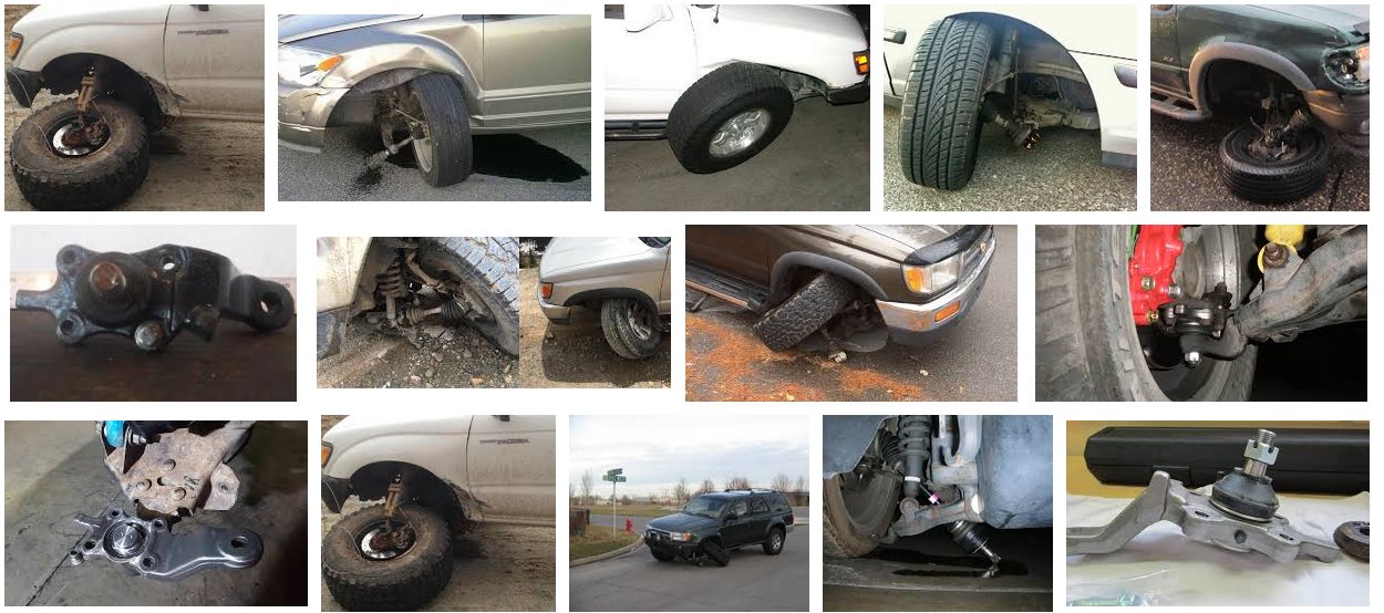

    Didn't find an LCA eye failure in my search, but I sure did find some other good failsScreen Shot 2018-09-22 at 1.59.42 PM.jpg . :D
