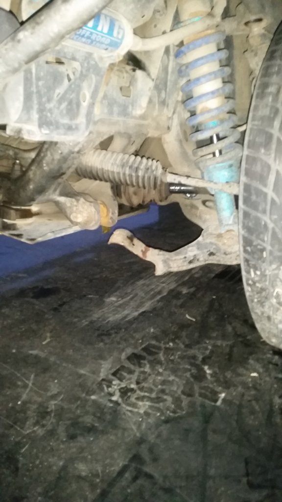

    ^That type of failure is EXTREMELY rare. Not something I would worry about. If you're wheeling THAT hard there are a lot of other things that need upgrading long before your LCAs.
