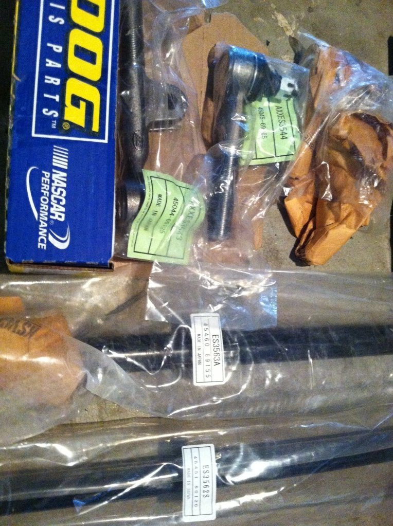

    Toyota typically uses Sankei 555 for chassis parts but I don't know if that's true of U.S.-made vehicles. I was under the assumption they were MOOG or Dana or some other domestic supplier. My only justification is that the Tacoma spindles have a slightly different taper on the ball joints than the 4Runner and FJ Cruiser so they are not interchangeable. You can use 4Runner arms and ball joints if you use a 4Runner spindle, but you can't mix and match.

    Also, BTW, it's not unheard over that MOOG just reboxes 555 parts, too. I would not be surprised to know that Sankei, MOOG, Toyota, etc. all point back to the same pool of suppliers making the arms and have the same sources for the ball joints.

    I used to buy 555 parts for my 1991 and they were definitely made in Japan. But that's been at least 5 years ago now that I last did those. I'm just now replacing chassis parts on my 2008 at 93k miles (which I actually bought in 2015 with 40k). I'm finding that it's not quite as clear cut with the Tacoma as it was with the Hilux/Truck back then.
    I tried MOOG ball joints on my 1991 and they were nothing like the OEM/555 parts. The OEM parts were much better and on a 1st gen I would just about 100% go with factory parts. But those are available as stand alone parts and the design is quite different than 2nd gen.
    On my Taco they appear to be the same in every way, although long term it's possible the rubber in the boots is cheaper or other things. Time will tell for sure. Camburg did send me polyurethane boots for my upper arm ball joints now that I think of it.
