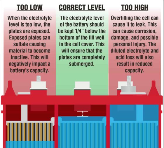

    Yes, you should top it up using only distilled water.
    Maintaining a proper water level is key to long battery life.
    I check mine every oil change.
    Above the plates but below the ring as below.

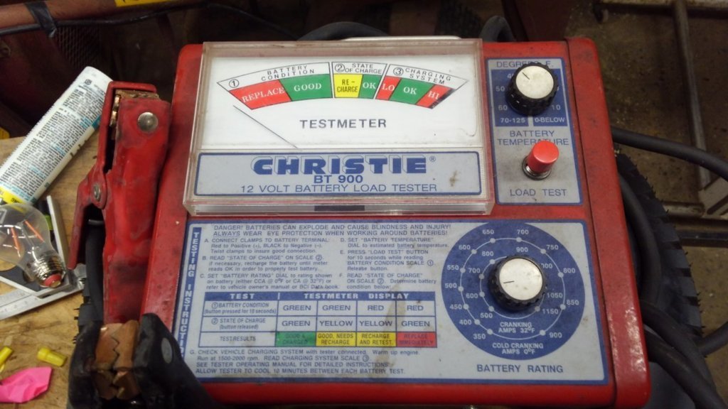

    I test batteries every fall with this old school load tester - 25 or so years old.
    If they pass I keep running them.

    Reminds me of the VAT 40 machines we used in school
    Inyo_man and RustyGreen[QUOTED] like this.
