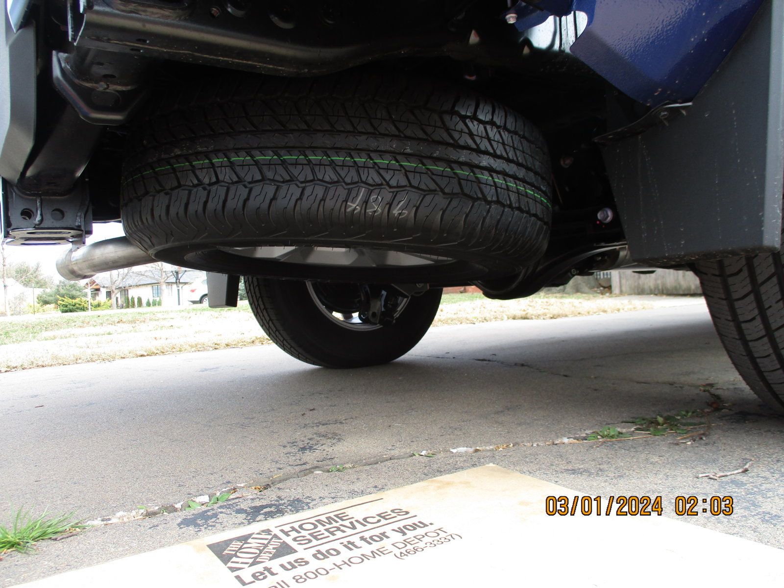

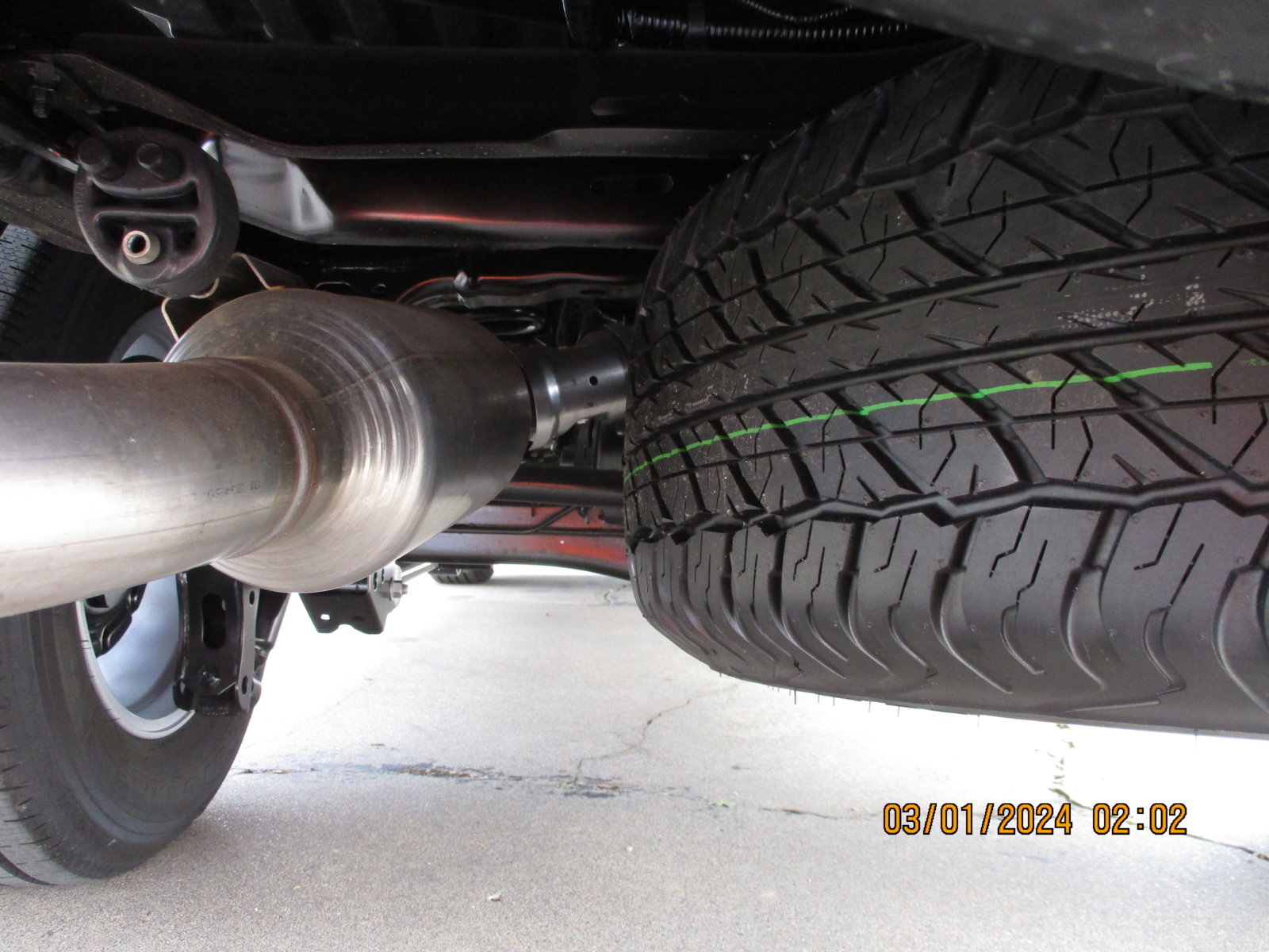

    Shown above is the 245/70-17 stowed underneath, also you can see there isn't an exhaust clearance problem.
    Does it make any difference which side is up for the stowed spare? With this style of alloy wheel, stowed outside up at least gives you a flat surface for the chain bracket. With the outside down, the bracket does not have that (and the fitment seems wrong to me).

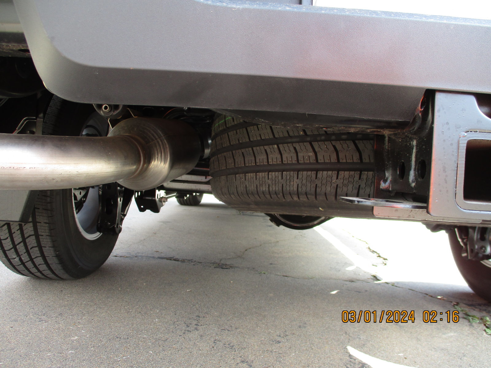

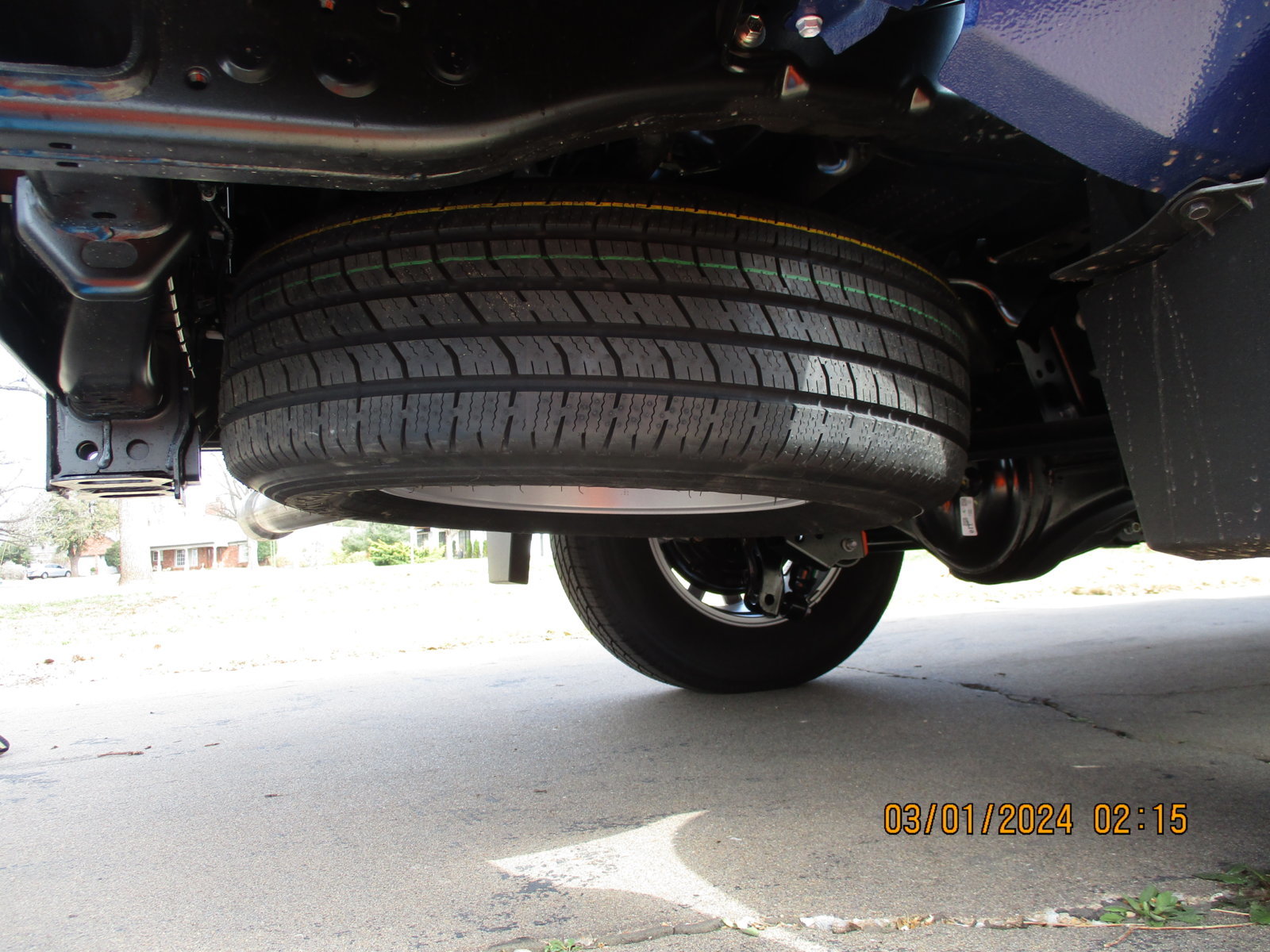

    Above is a 265/70-17 in the stowed position. No problem with the OD (of about 31.5"), but the width (stowed height) looks maxed out to me. It's probably not a problem for street use, but I'm not so sure about the offroad clearance.

    I think that’s the correct way to mount the spare. How much space is between the tire and exhaust? Would a 33” tire fit without touching? It’s strange that there is no heat shield.

    I've seen varied opinions on orientation of the spare. Not sure if there is a right or wrong. I think either direction works in the end. Some prefer to have the valve stem pointing down (outside down) so the pressure can be checked without dropping the tire. I like outside up since it doesn't flop around as much raising or lowering it and getting it out from under the truck (unhooked from the chain) seems easier. It also makes me take it down from time to time so I know if the mechanism is bound up and needs a shot of WD-40.
