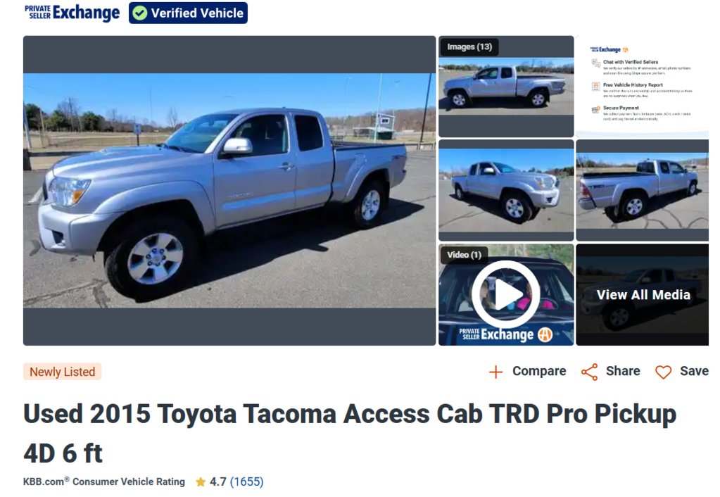

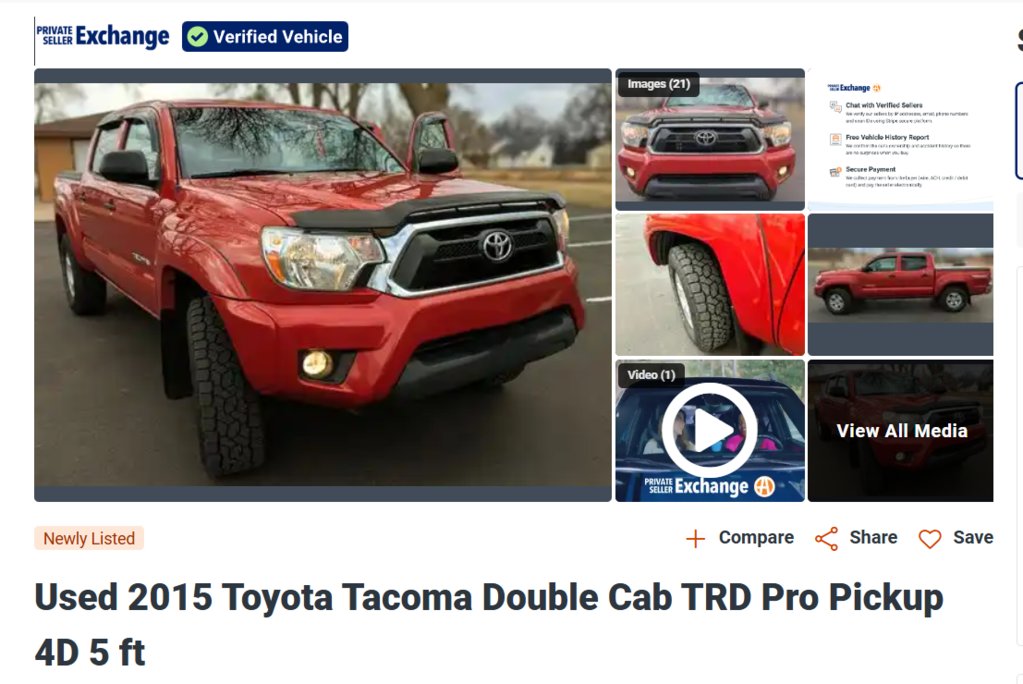

    I've been looking around for 2nd gen Tacoma, I've noticed a lot of listings that say a truck is a TRD Pro even though its obviously not. I check the vin#s on multiple websites and they do come back as "TRD Pro". I've noticed that its just the 2015 models and they all seem to be either TRD Sport or TRD Off Road models. Does anyone know what's going on here? Did Toyota just call every TRD model in 2015 a TRD Pro?
    Stuff like this

    I have one of those 2015 models and the sticker is TRD Offroad, not Pro. It has all the related options including 4wd, tow package, etc. but does not have the sporty TRD Pro options like the wheels and extra emblems, etc.

    Probably because the dealer either doesn't know the difference or they purposely call it a pro to raise the price.
    Just make sure if you go to buy one that it's really a TRD OffRoad, alot of that shenanigans goes on too where they have the stickers but they aren't a TRD OffRoad.
    Only the TRD OffRoad and Pro have the locking rear diff.

    It's not Toyota and it's not the used dealerships lying. For some reason VIN searches for these trucks are garbage and will not list the model of the truck correctly a lot of the time. The dealerships are just lazy and don't bother to double check what the correct model is.
    For 2nd gens:
    TRD Sport = Hood scoop, painted grille, no e-locker
    TRD Off Road = No scoop, chrome grille, rear e-locker
    TRD PRO (2015 only) = Hood scoop, painted grille, rear e-locker.
