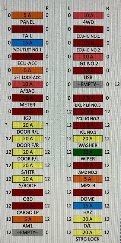

  8. Apr 9, 2021 at 6:31 AM
    ktbell444
    ktbell444 One who throws exceptions
    Aug 8, 2017
    #226306
    2,969
    ᚺᛖᛚᚺᛖᛁᛗ
    Here you go

    Pretty sure it’s that ig2 or the ignition fuse someone said earlier. There is a fuse for every window and it would make no sense for all of them to go at once

    If it is the IG2 fuse, then there should be other things not working.
    Anything else not functioning???
    Also consider, if a fuse is blown, then there is a problem the circuit the fuse is protecting.
