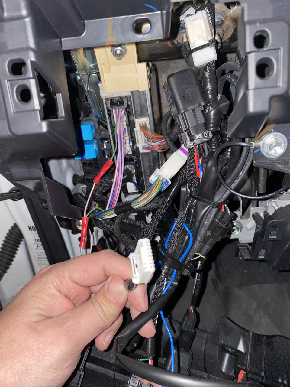

    UPDATE: I was about to take it all out then I noticed that this plug was just dangling. I could not find where it goes to save my life.
    (the electrical wiring you see tucked up is a factory DRL option installed by Toyota when the truck was new, not me) 0D96338C-2234-4389-95B4-027EBF601221.jpg

    It looks like connector P21; but that's supposed to be the front passenger window switch.

    I suppose that’s a start, for the life of me I can’t figure out where it plugs in.

    UPDATE: For those of you who helped, just wanted to say thanks for the attempts.
    Ended up being a bent pin in my OBD connector.... Got it fixed easy peasy.
