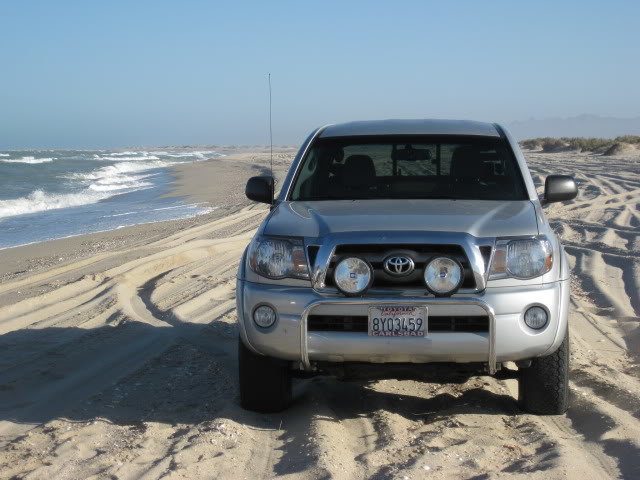

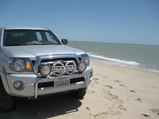

    How about South Padre Island... you are in Texas, and that is the beach you can drive on, right? My favorite four wheeling is in deep sand... not only do you use 4WD, but the beach I drive on is coarse sand (mixed in with sea shells and pumice), so dropping the air pressure in tires is very important.
    The nice thing about sand is, if you do get stuck (temporarily), you just need to let more air out. The sand is clean (unlike mud) and easy to dig, if you are down to your differentials!
