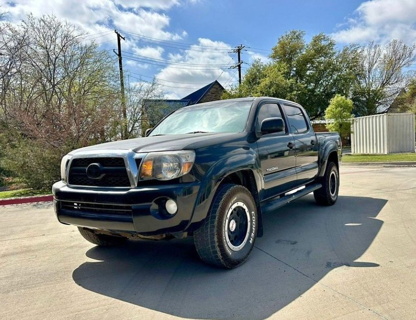

    2011 Toyota Tacoma DC
    Hi everybody. Noob here bought an old Taco that's actually in good shape, but has high miles. It's a 2011 4.0 V6 DC short box with 196000 miles with no misfires, hesitation or tranny issues (driving fine so far!). Body good, no rust issues either. The old lady hit me for $2K cash just to get it out of her driveway. I wanna replace all fluids, tune up and new tires. Dealing with tranny fluid has me a bit concerned. I'd like to run the truck over to Jiffy Lube and flush the tranny, but it won't get the genuine Toyota ATF. I think they have Castrol Synthetic. Heard that would be good, but would like everyone's opinion on flushing. Jiffy doesn't remove the pan, but they do use a machine that shoots in the new fluid that cleans and evacs the old. Ok to flush or no? Keep old fluid? Anything else I should look at as well? Like to get at least 2-3 years out of this truck. Any advice, tips and guidance is welcome.

    Welcome to TW! Looks like a TX Pro with those wheels! Is it 4wd?

    Thanks.......Ha Ha I wish. Not even TRD, no hood "scoop". AFAIK, it's just a regular 4.0 2WD with nice wheels. Not sure of the actual trim level yet, no badging. I'll look up the VIN and see what it really is.

    The TRD packages are based on the "Tacoma Base" so when you look up the VIN the first thing you will see is "Base" and then the options are below that.
