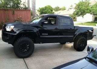

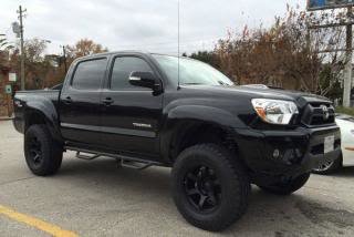

    Hoping for recommendations on a solid 3" lift and wheels and tires size recommendations. It won't be used for off-roading, just aesthetics at this time. Budget is a major factor as I work a commission-only job. Was looking at a 4 Wheel Parts to do the work here in Memphis. If ya'll could give me some direction, I'd greatly appreciate it. I'm posting a few Tacomas below that I love the look of for reference.

    That bottom pic looks stock to me, doesn't look like it's lifted at all. The top is probably coilovers if 4wd or spindles / coils if 2wd.

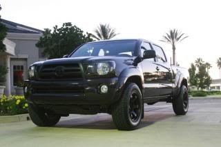

    Here's another one that gives me a taco boner.
    You can see what style I'm after.
