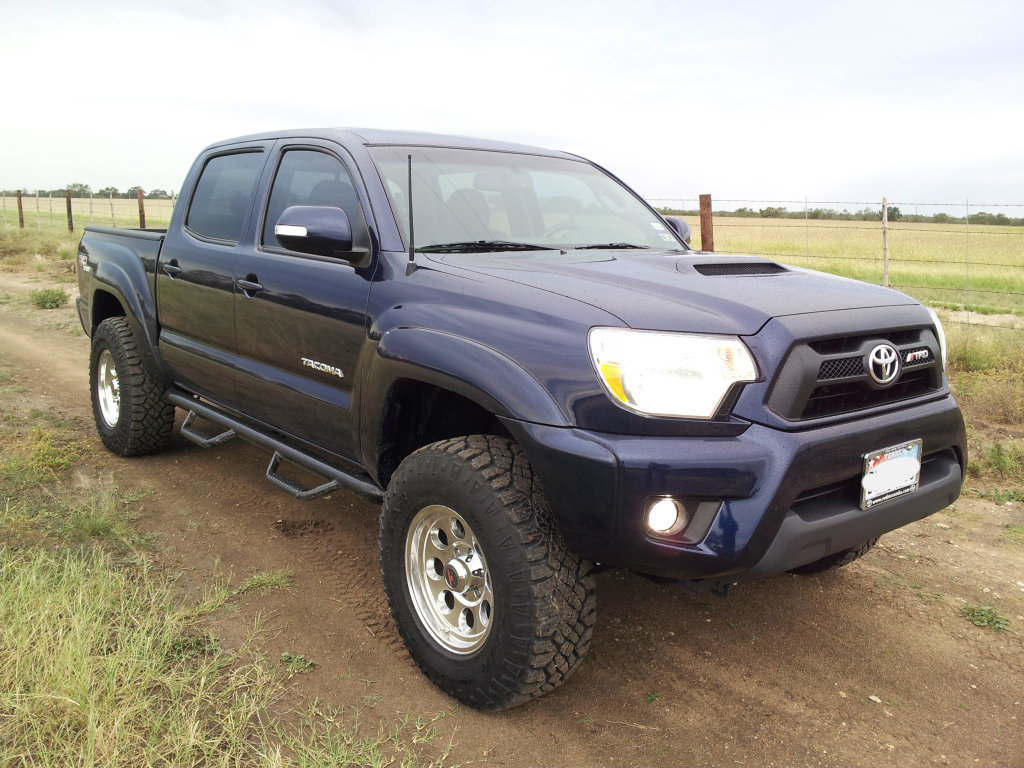

    265/75/16 DuraTrac 16X8.5 Level 8 Trackers HID, LED interior, 3" N-Fab step bars
    Duratrac 265/75/16 (265/70/17) would be the same size in diameter, just more wheel, less rubber than what I have)
    5100 set at 1.75 in the front.
    Aftermaket wheels will also give you the aggressive off-road look you seek.
