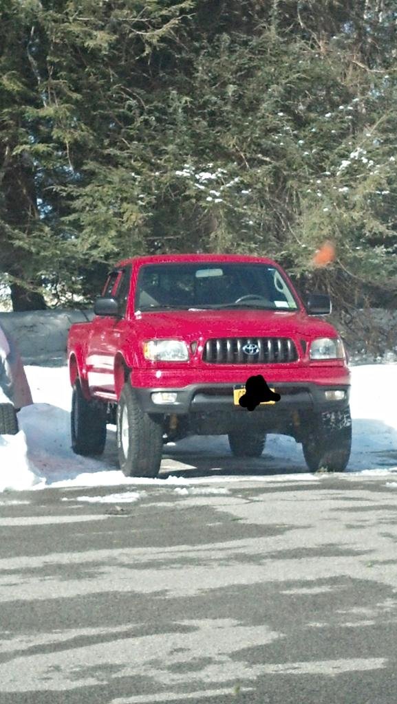

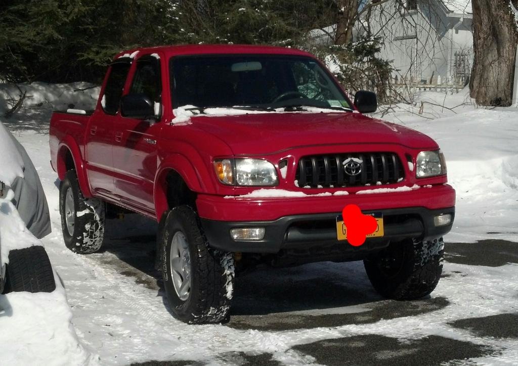

    IMG_20150215_124139_943_zps5xiazhkr_edit_88e7d7b1eb76a2967c95da118d9d7a1c4c0fd02a.jpg
    Only 2 pics I have handy. I just started a photobuck acct and these are the first ones I posted.

    ^^ looks great! Any vibration issues?
