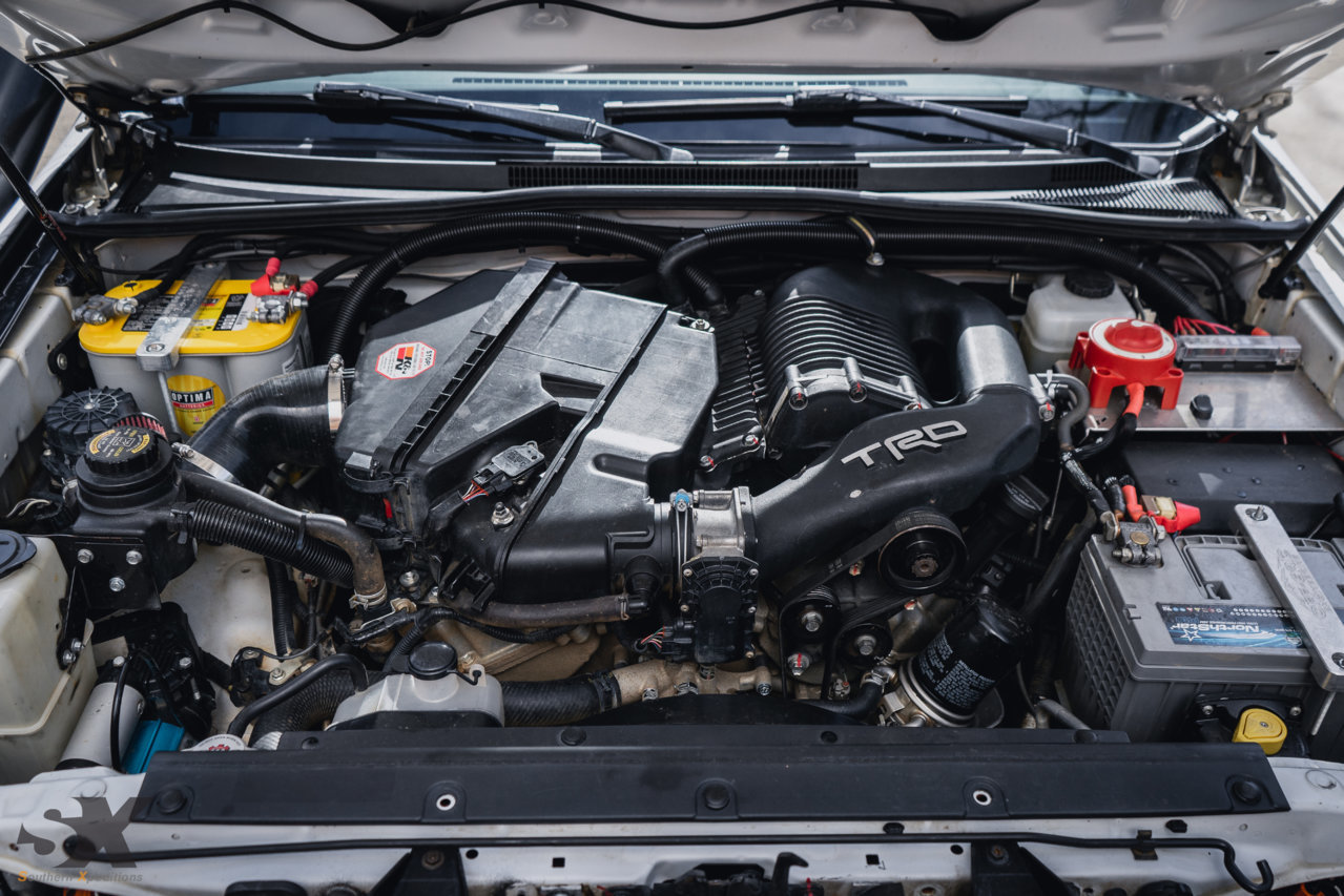

    Hey guys well i am not a NOOB here by any means having been lurking since '13 anyway i am new to the S/C game and trying to learn from everyone here and while i have read almost every tune thread i could find i like everyone else wanted to start my own thread to have my specific question answered and hopefully make it easier for others in the future to understand....
    That being said. a little about my truck before i get into why i want to tune this.
    2012 DCSB Tacoma 4.0V6 TRD Supercharger with TRD flash (done at the dealer)
    Truck is heavy as it is setup for long term remote travel (Overlanding)
    Re-geared to 4.56 - running 35x12.5r17 Tires
    Currently with 125k on the odometer I am replacing idler pulley's, belts and tensioner pulley on the S/C in prep for my Alaska trip coming up in July I want to make sure the truck is running 100%.
    I am looking to delete the Secondary Air injection pump assembly from under my hood saving all those horsepower haha Really just looking to get rid of it before it fails and leaves me stranded.
    I have the AFR/Boost gauge and Gauge pod on order to go in when i do this refresh in a week or so.
    Is there a way to make my Ultragauge stop showing my engine is going to 120% load when i go full throttle? It is way off with the tune from the dealer.

    I'd be happy to assist you with your needs and get you squared away if HPTuners is the way you'd like to go.
    Regarding your question about the Ultragauge.. The supercharged calibrations will report higher than 100% load. I'm not intimately familiar with the Scangauge and if it's scanning Calculated Load or Absolute Load, but in any event, the TRD S/C will produce airflows at specific RPM's/throttle positions which exceed that of what is possible at atmospheric pressures, and thus will exceed 100% load.
