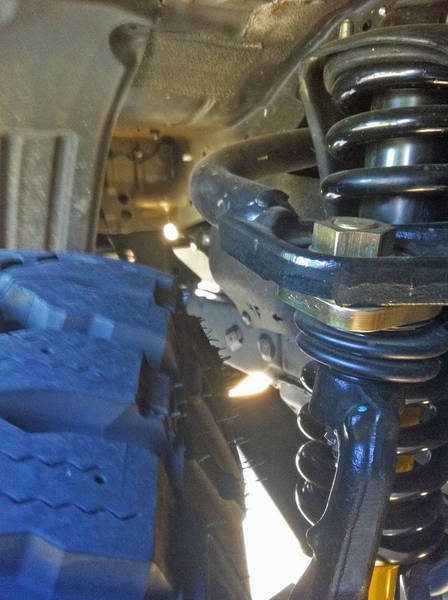

    On another note. I need to push my front wheels/tires out more with the new suspension (front tires rub on my Light Racing UCAs during a sharp turn and suspension compression). Should I get spacers, wheels with less backspacing or different UCAs? Any input would be appreciated :)

    emblems and decals removed, added TRD special edition badges, Sway A Way's front and rear, SCS stealth 6's, Toyo A/T II 265/70/17
    Suggest SCS wheels 4.30 back spacing, if you decide to go with different control arms I am interested in the LR UCA's. SCS come in several colors and set tires out at the edge.

    Debadged, took off front mud flaps, prevent tailgate theft mod, Magnaflow 18" muffler, Bilstein 5100s front and rear w/ front @1.75, wet okoles, plasi dipped front emblem, weathertechs, scangauge, toolbox, Bed pocket lights, BHLM, T1 eyelids, BAMF sliders, Bruteforce Fab rear bumper
    I know the F5's and F6's do have different offsets though, so that could make a difference.
    F5's are 4.50 back space, 6's with 4.30 net .20 of an inch. almost a 1/4 inch. 1/5 of an inch. yet a 17" tire instead of 16".

    If your issues with rubbing is 1/4 of an inch, there has to be other cheaper ways to fix the issue than buying new rims and tires.

    Yeah, the idea of new wheels and tires is not very appealing to me right now :)
    So far, it has only happened under a specific set of circumstances. Basically, if I go into a tight turn while slowing down, the outside tire rubs on something. It has happened twice now. First time was rubbing on the driver side front while making right hand turn while slowing down on a decline. The second time was on the passenger front when turning left and slowing down on a incline.
    It almost feels like the outside tire broke traction. The second time it happened is when I figured something was rubbing. I can't find any definite rub marks yet so it hasn't been real easy to diagnose. Pic below is why I'm thinking it is my wheel/tire/UCA issue. The picture is the driver front tire turned full right.

    1in spacers up front should do the trick, pretty cheap too compared to new wheels

    I dont see any rub marks on the UCA, sorry if I misunderstood issue, thought you were rubbing on control arms. Looks like a lot of clearance there. Looks nice and clean, can you find any areas where it shows a rub mark?
