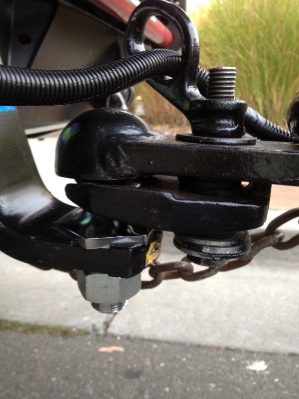

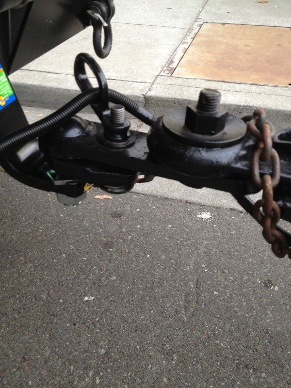

    Cool, it looks like one. Get rid of the ball stuff and see what you have under there.
    Great score!

    Thx, will do. Just a cool utility trailer for now... But future overland trailer plans will undoubtably surface! (Can't leave well enough alone!)

    You've got a lunette ring to standard ball adapter. So basically an on-road usage ball coupler. You could pull the adapter and use a pintle hook.
    Personally I'd cut the whole thing off and replace it with 2.5"x2.5"x.25 wall receiver tube and use either a max-coupler or lock-n-roll hitch.
    Correct, they limit articulation.
    For the size of that trailer there's not really a strength problem assuming it's a 2" ball with a 1" shank.
    As for the pintle hook/lunnette ring, they were cool 10 years ago when that was all that was available to get more movement out of a hitch. Problem is every every time you have to slam on the brakes or accelerate fast it's like a 1500 pound sledge hammer hitting your pintle hook/receiver hitch.
