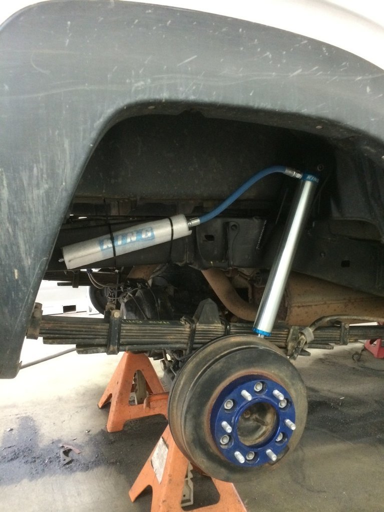

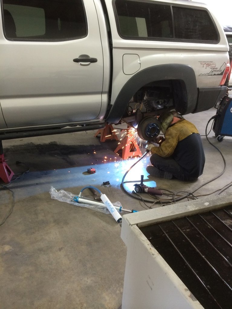

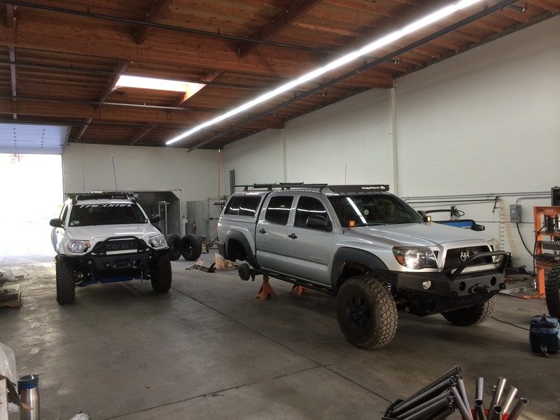

    Speaking of BAMF shock kits, and kings...
    This happened yesterday.
    The Man hard at work.

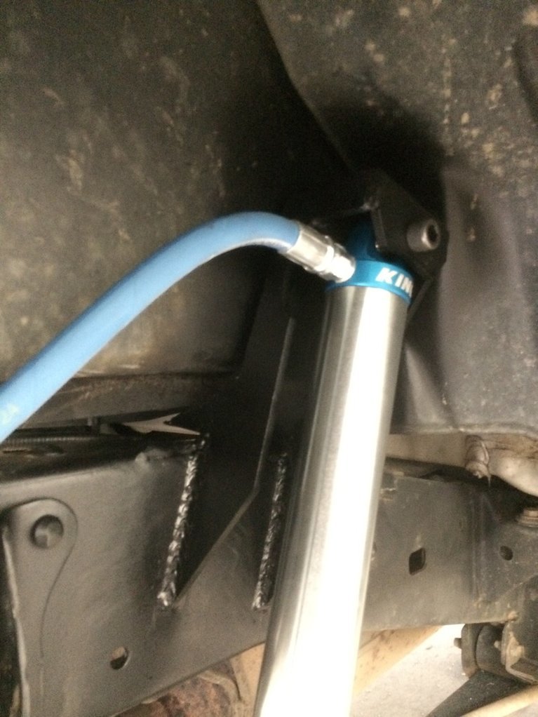

    Finished product. Yes I am using zip ties for my resi mounts... For now. Gotta come up with something clean.

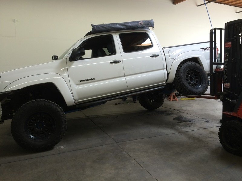

    Nick's truck on the Flex-o-meter.
    Nick and I both had the relocate kit mounted, He went with Fox and i went with King. HUGE improvement on droop, and a much more plush ride on my end. I Can't wait to really test it all out.

    I wouldn't worry too much about the rust either, I ground my frame down to bare metal for the weld on sliders and have zero frame rust issues. As volcom said, good primer and a solid coat of rattle, I use rust oleum bedliner, and it's good to go. I crawl under there and check it every now and again, shoot a few spots where it needs a touch up, but no rust.
