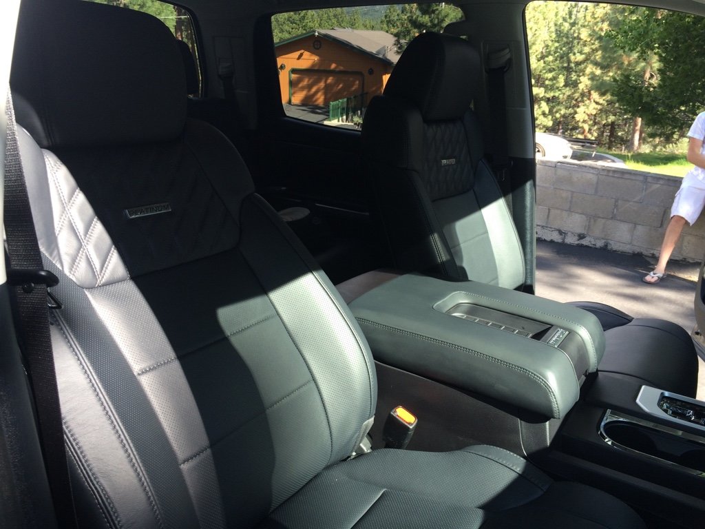

    Pleeaaase. I got butt warmers and vagina coolers.

    Do want coolers. My clam can get toasty on these summer days.

    And a center console that turns into a frig?

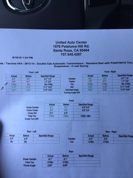

    Any thoughts? Stock UCAs, not quite 3" lift.

    I know I need UCAs but is this about the limit for stock UCAs? Wondering more if the shop is worth using again.

    seems fine to me, but its gonna be jumpy because the caster.

    A bit jumpy, otherwise seems pretty much to drive the same as before I lifted the second time. It's hard finding a decent shop. I didn't expect a vast improvement as I'm at the limit with stock UCAs.

    You're going to roll the outsides of the tires with positive camber on IFS like that. Especially if you drive up in the foothills much by your house. More importantly, you can gain my positive caster by sacrificing negative camber. In other words, if you were rotate the front eccentrics inwards, you'll not only get camber in a better spot, it will give you more positive caster and it won't be as shopping-cart-ish.
