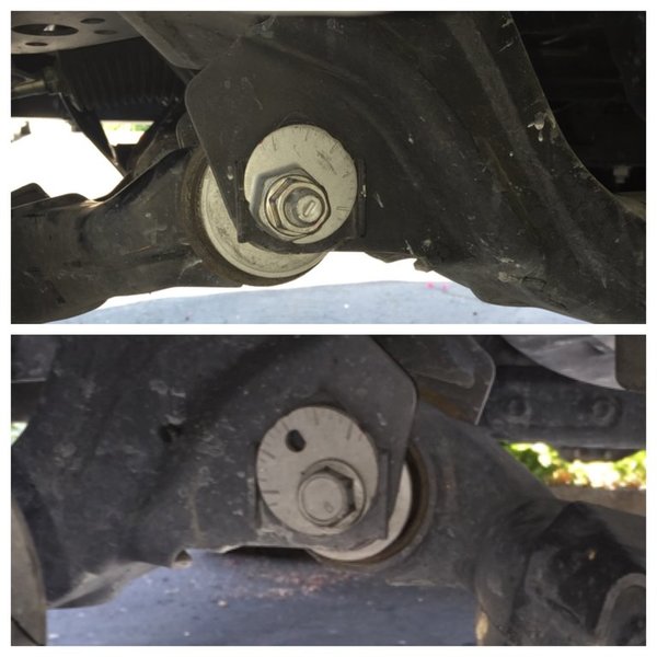

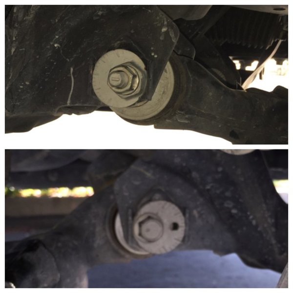

    Top is driver rear. Bottom driver front.
    Passenger side, same locations.

    Mkay I see. Passenger side is maxed out. Driver is almost maxed. They basically set the eccentrics to all the way "longer" on the cam bolts. Meaning you can't get any less camber if you tried. You could adjust to get more caster, but you'll get more positive camber too. It looks like the alignment tech aligned it so that you won't wear out the tires. Camber will affect tire wear. Caster "mostly" doesn't affect tire wear, just handling characteristics.
    Did you do actual lift measurements of your truck before and after you installed the lift? Reason I ask, is as you lift the truck, it will add positive camber. I don't think I've ever seen both eccentrics maxed out like that before and still have positive camber.
    Either way, time for UCA's my friend.
