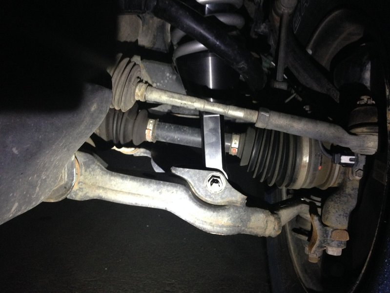

    Holy preload!

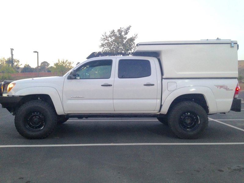

    Weight was completely off the wheels. Made sure I could spin them before starting. The top of the collar was 1-7/8" from the end of the threads/ bottom of the top cap from the factory. I'm now at 2-5/8" DS and 2-1/4" PS. Hub to fender is 22.5" on both sides. Not much lift. I do have Dakars, with the extra leaves, and it's sitting level. The camper, cabinets, and 14 gallons of water are in the back now. My truck is usually in "prepper" mode.
    Driveline angles are still decent.
    I think it looks like a lot of preload since the fox's don't have the top lock collar anymore.

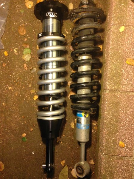

    The springs do look short though. Look at them next to the 5100's & 885's set at 0.
    These are the "extended travel" ones too. Same length as the 5100's. Lame.
    I'll probably end up getting some 14" 650 lbs springs. I liked the spring rate of my 885's - not the dampening. It rides so much nicer now with minimum oscillation.

    Compressed spring length is only 9"? How does that compare to Kings with 2.5" lift? Plate bumper & winch.

    The preload looks normal for the fox coilover. I have the same ones and switched to 14x650. Basically the collar moves freely down 1-1.5" of the body before even reaching the coils with my 14". So I only cranked mine about .5-1" with any tension on the collar. Makes it look like they have a crap load of preload but really the same amount as any other coilovers.

    The real thanks goes to @ffdawson for lending them to me. Im just glad they worked and you were able to get them adjusted before you bent or broke all the tools in your toolbox!:p
    Definitely sitting much better now:thumbsup:

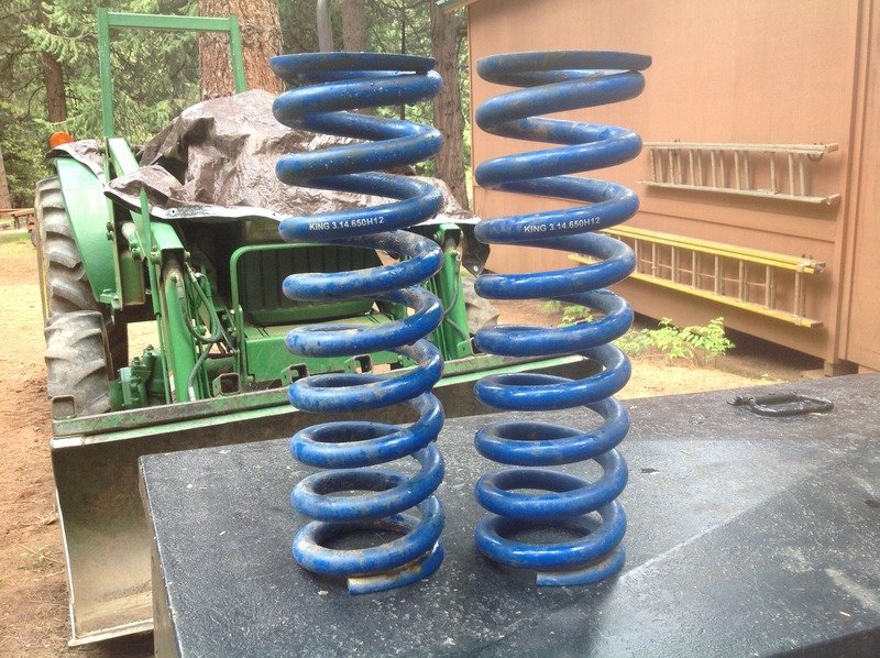

    found a picture of em...they wernt on my truck for long, went to 700's, then made myself some long travel crap

    Nice! Assuming the 3.14.650 is 3" x 14" 650lbs. PM me yer price.
