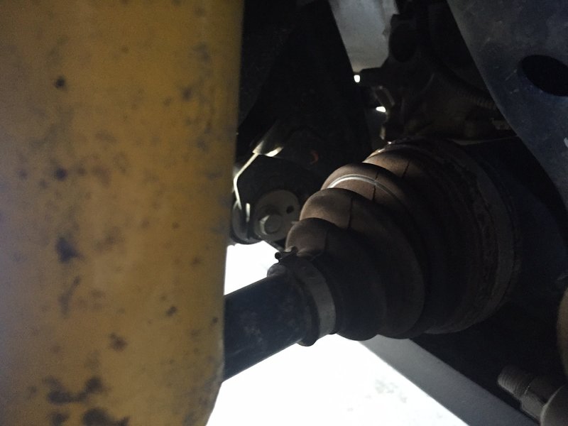

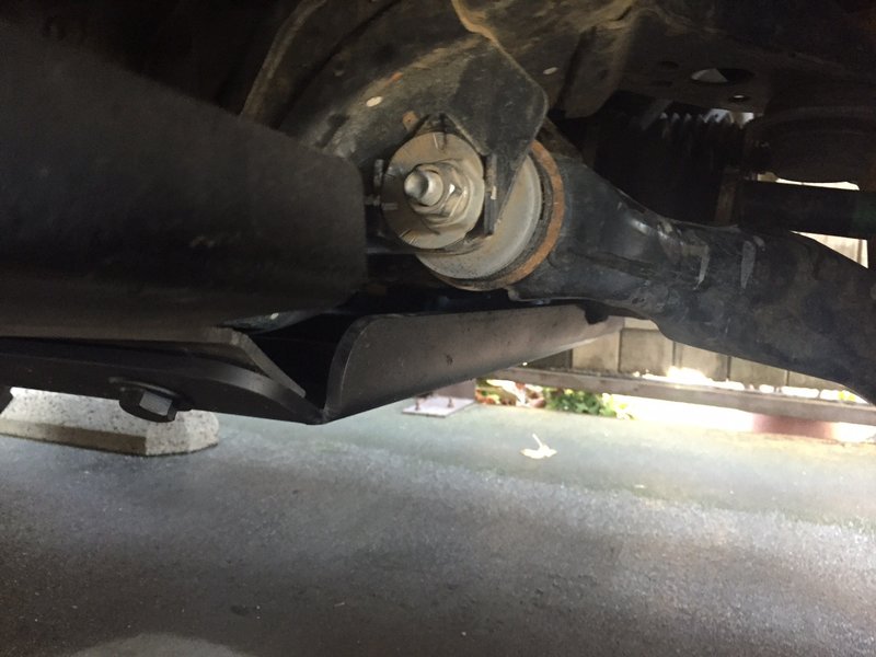

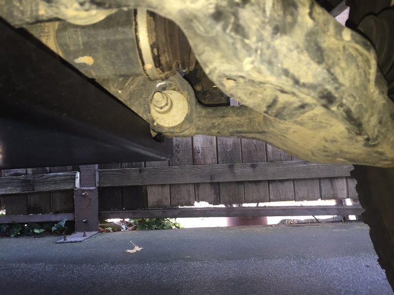

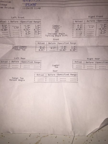

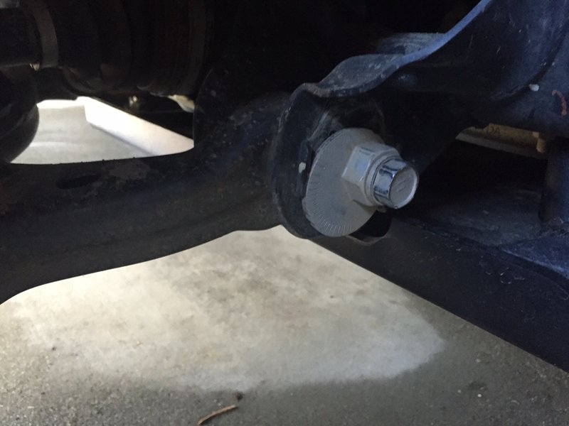

    Argh, not too happy with the alignment. Said couldn't get right side caster above 2.0 without increasing positive camber also. It's maxed out. I feel a pull to the right, they say it tracks straight. Told me it was tire drift... And tire wear should be perfect, blah blah blah
    Alignment sheet
    Front forward eccentric
    Front rear facing eccentric
    Rear forward facing
    Farthest rear
    Can I ask the Internet wizards (aka @jberry813) for some advice?
