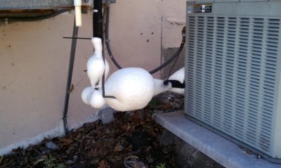

    Any HVAC peeps around here?? Or know HVAC peeps that may wanna help a fellow TW member out?? In Brentwood, AC is acting up! :annoyed: My HVAC knowledge goes as far as GOOGLE takes me, ya dig?:pccoffee: AC been freezing up this afternoon...air filter is clean, which by my GOOGLE knowledge tells me refrigerant is low or leaking....or both. Any info is appreciated! :pray:

    You mean the condersor unit outside is freezing up outside the coils?

    Sure. There is some piping/tubing going to the unit outside which freezes up, yes. Shut off the AC let the fan keep blowing and it defrosts if ya will.
    Like this photo attached....not my actual unit.

    I know it's not a vehicle but my old truck did this and it was a clogged condenser which caused it to not properly flow and would freeze up and stop blowing cold until it defrosted.

    Thanks! I'll look into that in the morning....luckily it cooled down significantly!

    If your AC is freezing, it's could be dirty coils(inside or outside), low gas, or a restriction in the line(clogged filter dryer). Make sure the unit is completely defrosted before turning it back on, otherwise it will freeze right back up.
