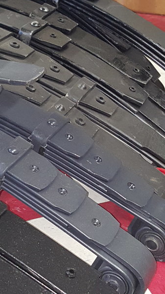

    Dakars, Springs drilled and isolator pads installed by SpringWorks in Santa Rosa, 10$ a pop, 80$ total with new center bolt, total silence...

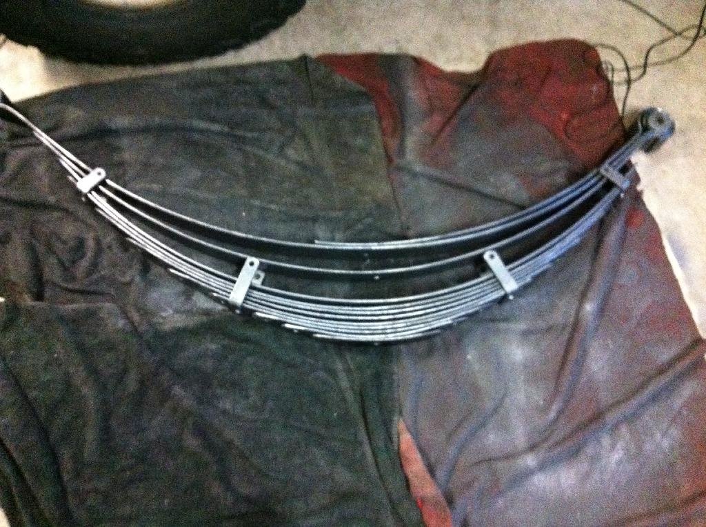

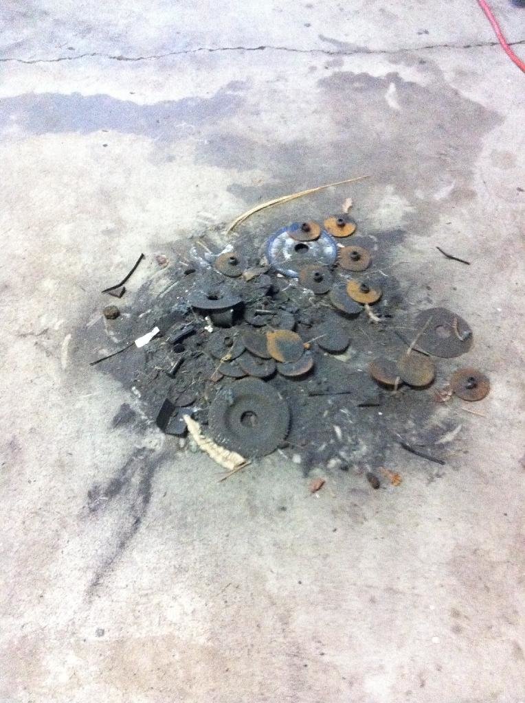

    The pucks work great for most street vehicles. Once shit gets in between the leafs and they start to deteriorate and everything goes to hell. After countless miles of dirt excursions, half of the Teflon sliders were broken or missing. On top of that the remaining pucks were pretty much worthless from gouges. The pucks are really intended for street trucks. The pucks leave a gap between the leafs, and with trucks that see a lot of dirt miles, the pucks cause more problems than they resolve. My leafs were coated with dirt, grease, sand, and god knows what else and made it impossible for the leafs to slide gracefully.
    So...I broke down the leaf packs completely and removed the remaining pucks. Wire wheeled and sanded every single leaf, top and bottom. Radiused and chamfered both ends of every leaf. Followed up with drowning each leaf with a quick dry aerosol moly lube. It's way more labor intensive but to date they still slide like butter.
    870CB3B3-E26A-4362-B79A-5F442F79BD35_zps_f71393387873c109cc105008e90e70480e8b9bae.jpg
    And the pile of shit that came off the leafs:
    9B5C7E8E-0F8F-4749-9B84-E8B6C3143C3F_zps_cdf675190dbf7eac017d0f2eaf50ccab1fc7d675.jpg

    Pic of leaf Springs awaiting install at Yodaman in Santa Rosa, seems most manufacturers use the isolators on most leafs, unlike OME dakars.. I'm going to add the moly spray you recommended, hopefully will make the pads last longer20160627_150002.jpg

    You used the moly spray on bare metal after sanding etc? Interesting... I see in the reviews for the spray that it dries like paint, some people use it for AR mags to restore the lubricating finish
