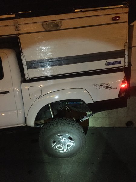

    Good times last night. Finished around midnight and took her out for a spin.

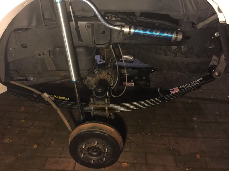

    Full droop.

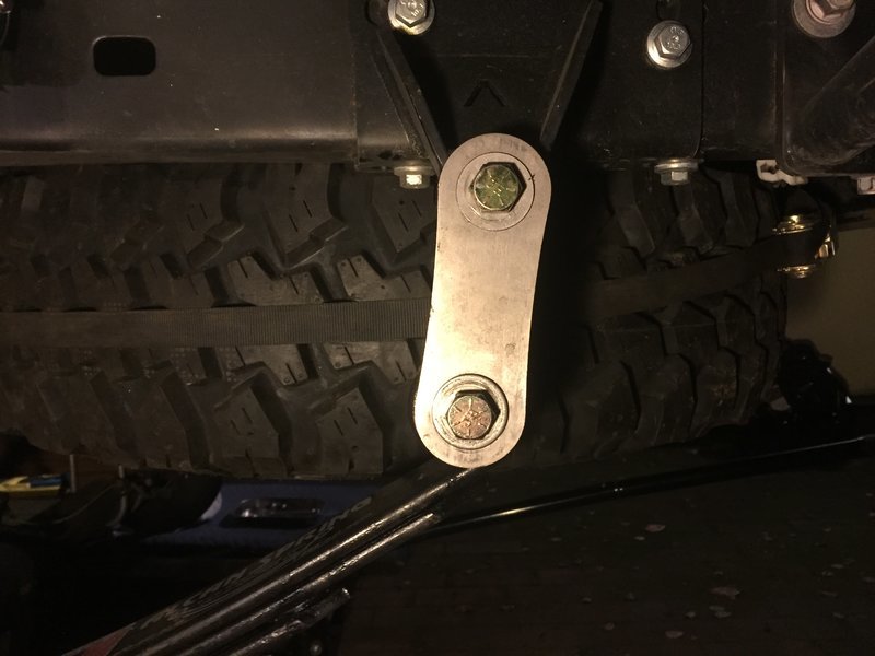

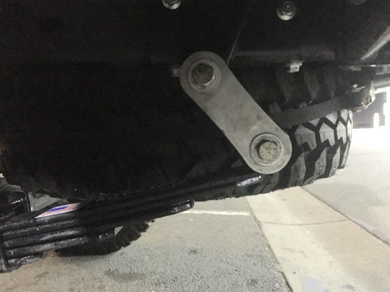

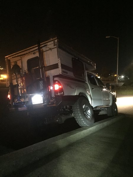

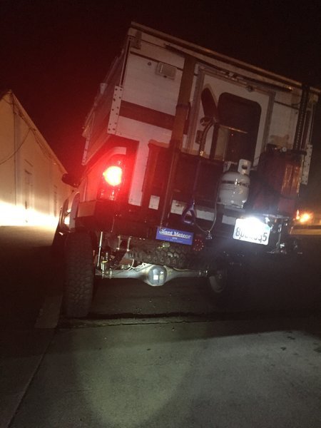

    At ride height.

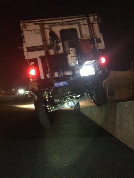

    27" up the wall.
    #mallsohard
    About 3" of shock left.
    Rides great. About 26" center of hub to fender, but they should settle to 24 or 25". So about 3" lift.

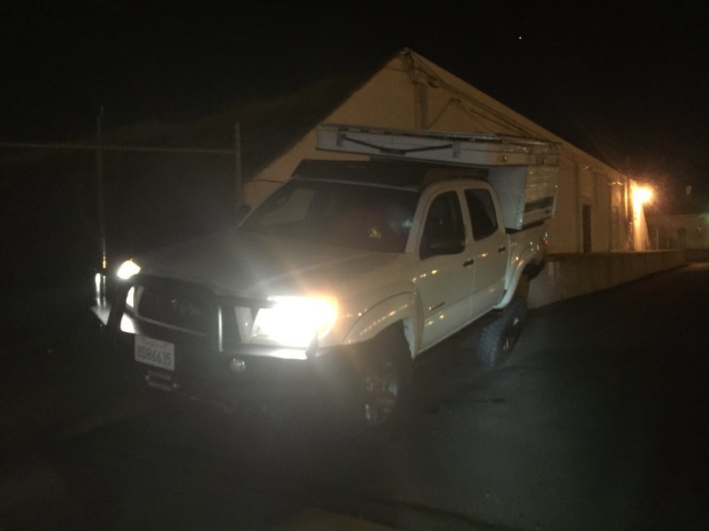

    May need to adjust the headlights.

    Is the shackle bracket in the forward (Dakar) position still? Do you have more shackle angle now with new springs?
    I may move my bracket forward 3/4-1" for better angle and to stop it from inverting at full droop. What's another 8 holes in the frame, right?!?

    I have it in the Dakar position. The Dakars measured 52-3/8", and the Alcans were at 53-1/2" IIRC. My shackles were negative with the Dakars, but it didn't seem like enough to make them go reverse. Haven't wheeled since the flip kit though.
