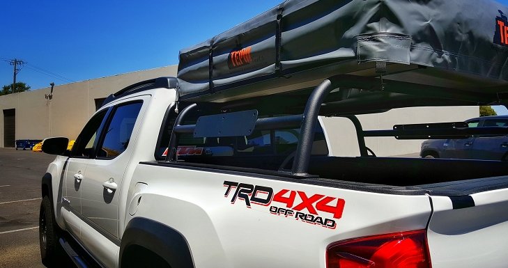

    you could use the t rail system on the bottom of the tent

    Holy shit, you're right huh? Just got to make sure the measurements line up I guess.

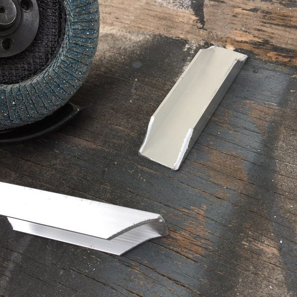

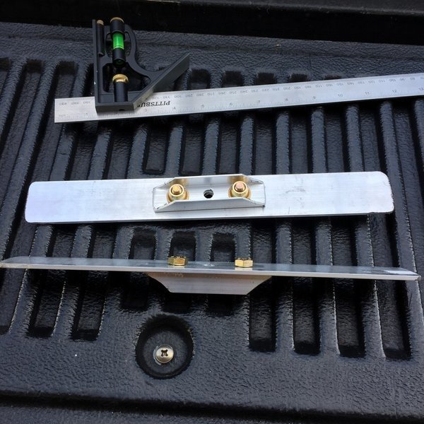

    Thats pretty cool, what exactly did u use for this?

    No, i know it was for max trax, i meant what materials from osh?

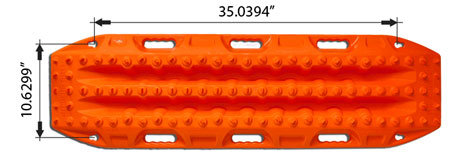

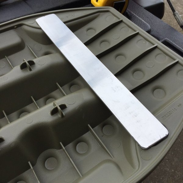

    Aluminum C channel and aluminum flat stock. I used rivnuts to hold them together but that was mostly because the rivnut kit was new and I wanted to use it :). Measure the mounting holes across on the max track and mount the max trax mounts to them.
    Pretty simple, I actually did a write up in my build thread on it, surprising I know, one of the only things I did myself that Cody didn't do.

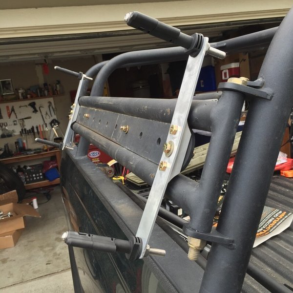

    @Porter707
    I mounted mine off the rack using fourtreks mounts like these...
    with longer bolts off the ends and a wing nut on the end for easy on/off
    End result:
    I don't really have any up-close photos but you can always swing by to see how it all works :cheers:
