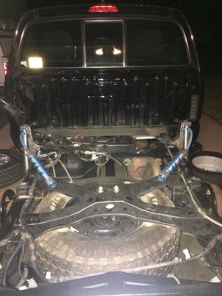

    So I tacked the driver side at 4.5 and went for a test drive and just leaving my drive way I used 2.5" so I'm gonna go ahead and clock the passenger side down to 4.5 and call it a night burn it all in tomorrow

    Ended up at 4 and 7/8ths per side for up travel lol. This is why we tack first haha time for a beer

    Still tacked? You might want to check to make sure the bed doesn't rub the mounts.

    Yea still tacked I can't imagine the bed will rub there isn't a whole lot of room to move the mount on the drivers side due to the factory bump and bed mount
    How close are your guys set ups?
