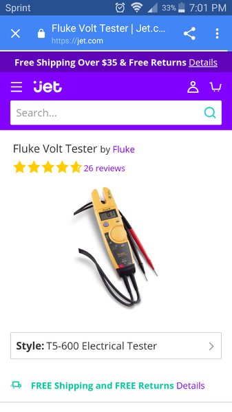

    ian408 and Speedo like this.

    So many buttons.
    And pokey things.
    :goingcrazy:
