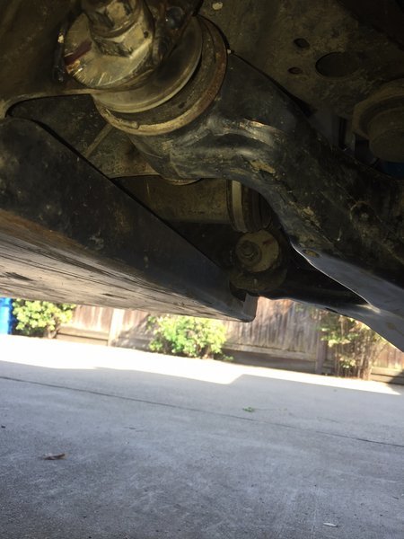

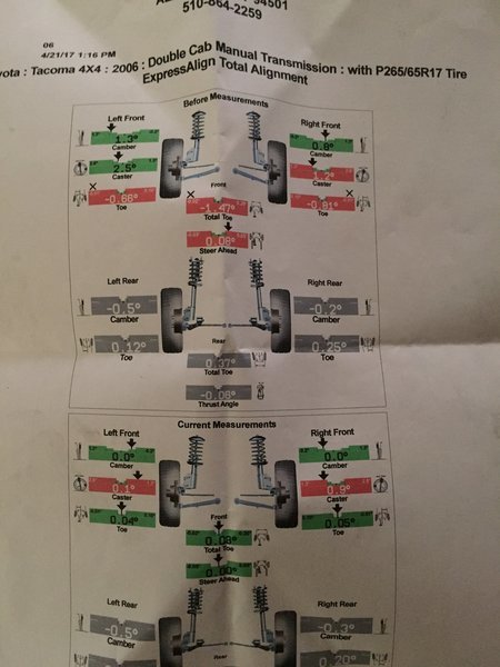

    I can't fuckin stand those guys. Fubar'd my oil drain plug on my first gen. Accused me of coming in without a center cap. Wouldn't even go look for it. Then they did and it was right there. Flipped my friends dad PT cruiser :)rofl:) on a test drive. He hires fuckin idiots. Trust me, I went to high school with half of em

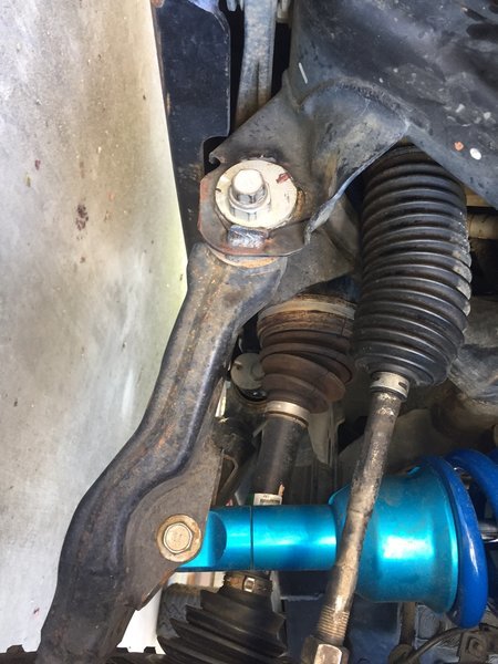

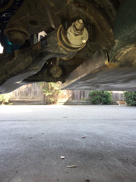

    That looks like utter shit. You can definitely get more caster out of those and still keep camber in check

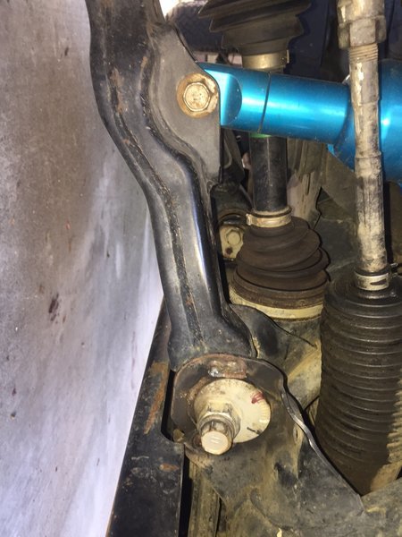

    @BudMan if they are letting you in the shop bay, try this:
    Max the front eccentrics shorter (head of the eccentric is closest to the frame as possible) and max the rear eccentrics longer (head of the eccentric is farthest from the frame as possible). This would be max caster.
    Then rotate the rear eccentric shorter until you can get camber in spec.

    Have you tried El Cerrito Tire near Costco? Their usual alignment guy is pretty good. Always able to squeeze 3.5 caster or more out of my TC arms. And their shop monkeys actually use torque wrenches.
    Not sure why I'm suggesting them though. They don't allow me in the shop anymore.
