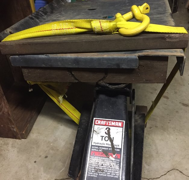

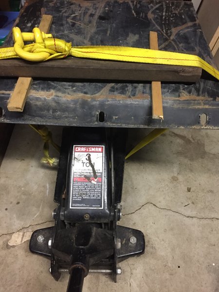

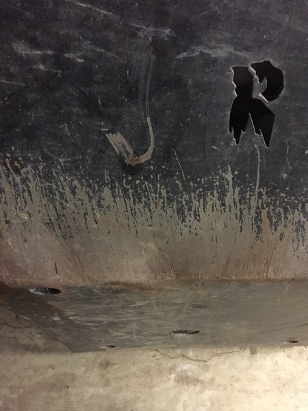

    Late night skid plate straightening does not involve bfh. This didn't work very well though. Don't worry- that strap was already relegated to controlled environments and will never see the trail again.
    It moved...a little.
    Any suggestions? I'm either going to take it to someone who has a press or live with it. Maybe try a bfh, but I'm skeptical that it would be effective. I'm not concerned with the cosmetics of my underbelly.

    why? they wont line up? flatten out when bolting with a jack.

    Bent upward. Not sure if they'll line up since they were removed for the regear. Not going to put them back on until the 500 mile drain & fill this week. I'm also going to change out the tranny & t-case fluid while I'm at it and maybe get the crossover done if there's time before the weekend. Probably just going to leave the dents and call it good. Hate painting over dents, but fuck it.

    When I hammer mine out I block it up on a couple 2x4s, put in some ear plugs, close the garage door so the neighbors don't think I'm weirder than they already do, and go to town with a 10lb sledge. Steel is pretty malleable when you're wailing on it with full overhead swings with a hefty sledge.

    I usually lay mine across some boards and then drive over them. Depending on the drive up, board in front to ramp onto first.
